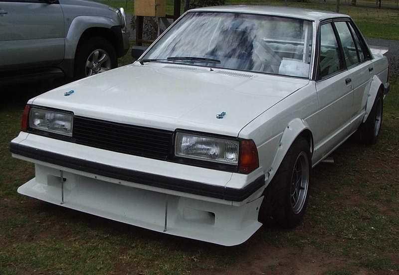

    Just to answer your PM Steve. A picture tells a thousand stories.
    Obviously this is a TT142, but you could pick up a cheap RT142 for a few hundred and sell the 22R easily on ebay to recoup costs. It'll have a W5* box in it already and an F series IRS rear end. May even have disc brakes. No idea on weight however but probably around 1100 kg or so.
    Just remember that the cheaper nastier ones with the 2S (ST141) will have Borg Warner gearboxes and diffs - best avoided unless it's a freebie.
    PS - Love the idea of the 2AZFE.

    the corona with the F series IRS rear end was sold in australia as the "RT142 CORONA AVANTE" and they do come with discs on the back same as the ma61 rear discs i think.

    So do majority of CSI RT142 though some have IRS like Phonbia on here

    That definetley would be a good thing, fairly light, decent track and big radiator intercooler opening, also the front bumper sticks out and a decent splitter could go there.
    Adam Allan has built a bluebird to replace his 1200 Coupe, they are similar to the corona except it runs a solid rear axle. He has been doing testing with his and the times are impressive already straight out the box.
