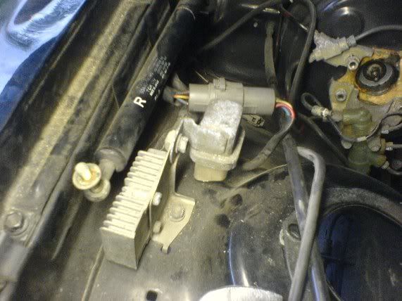

    Junior Member Backyard Mechanic Hash_ra23's Avatar
    385
    Default Re: fuel pump relay in ga70
    is that the one there? with the resistor?
    damn, i ruled them out cos the wiring colours differed from my wiring diagram. oh well.
    thanks for that guys!
    3,468
    That's the one!
    The bit with the fins is the resistor of course and the other part is the relay
    Wiring diagram colours are usually little help! They always seem to be different!

    The fuel pump resistor is well different to the fuel pump, my guess as to why it is in the engine bay is that its an easy spot for it!
    Main connections to the fuel pump resistor are:
    *Fuel pump
    *Battery via COR
    *ECU Trigger (low / high)
    If the fuel pump resistor was at the pump then the battery and ECU trigger wires would have to be longer....and that'd be silly! So I guess they put it as close to the battery as was easy
    Edit: Meh it has to double back from the COR, but to me it'd make more sense if the COR was in the engine bay with the other relays!

    ahh so is it a bad idea to put it under the dash somewhere in the ra23? Thats where i was thinkin of putting it, i didnt know it heated up but that explains the hardcore looking resistor
    and no the fpr doesnt power those things kyosho....
    3,468
    kyosho might have got confused with the Main EFI Relay?...
    As for heat, lets say the Fuel pump draws 6A at 12V (the resistance of the fuel pump is 2Ohms... in this example... )
    Now when we add the fuel pump resistor inline we get a total resistance of 2.7Ohms -> 4.44A now, and we have 4.44A * 4.44A * 0.7Ohms = 13W (P=I^2 R) of power being dissipated in the resistor...
    13W might not sound like that much, but meh
