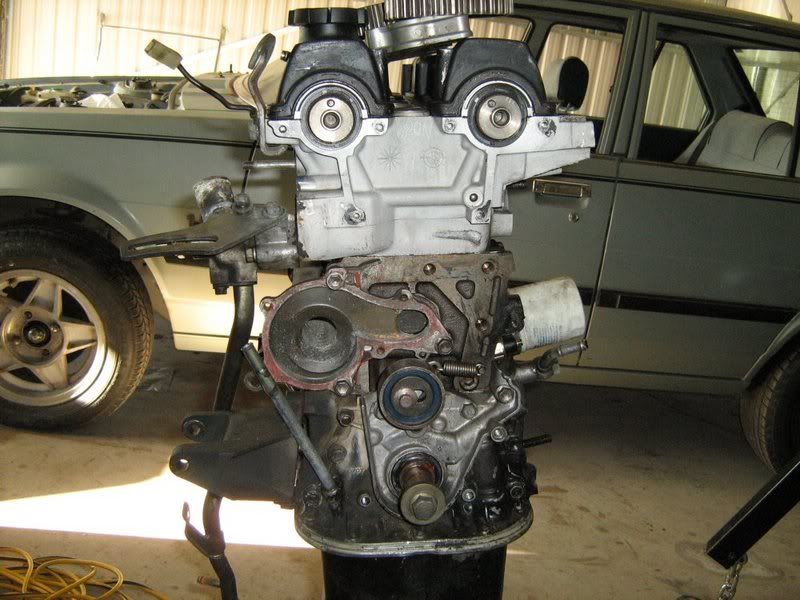

    those look like 9.4:1 pistons. If it's only got the 18/40 bottom end I personally wouldn't even bother putting it back together. If you've got an intended application for it you're probably better off starting with a better base engine - ie smallport AE92 hi-comp.
    I want to get into circuit racing with my ae71, Saterday afternoon sprints at QR etc.

    Thoses pistons are bluetop 9.4:1.

    Head needs attention but im just going to go with a factory rebuild, No special parts.

    Auto 1 and Repco don't have a listing for a 18/40 bottom end, Toyota has new parts for late model aw11's.
    I need new pistons so.....

    from memory ACL do pistons bearings everything for both the 20/42 and the 18/40
    there are also a couple of vairations in terms of piston ring size as well.. from memory there is a 0.8 0.8 1.0mm and a 1.0 1.0 1.0 versions (someone correct me on sizings) but from memory without looking it up the early 3rib/18/40 engines had a smaller ring height.
    can someone else shed some insight into this ?
    thaty might be a nice way of identifying your pistons... although that one is looking a little out of round ahahha

    I would have said it was an AW11 motor do to the Crank pulley. I've had my fair share of 4AGE's. Currently have an AE86 Kouki motor (Bigport 7rib). Great Motor it is, seems to have been rebuilt in japan as it still holds near factory compression and goes like the clappers.

    Quote Originally Posted by Sam_Q
    wouldnt all bigports be 7.8mm?
    7.56mm for the bigport and 240 deg
    7.1mm for small port and 232 deg
    FWIW its a RWD drive engine pictured in the first pic of this thread. ...... You can easily tell as the head doesnt have the mounting holes for the engine mounts between the cam gears
    Also i believe you have the 88-89 4AGELU with the 9.4:1 factory comp ratio.
    This will be helpful when ordering parts.

    Ae82 bigport, No mounts on the head, The mounts go just under the head. 4agze is the only 16v to have mounts in the head.
    hmmmmm .... ok
    I thought the mounts tied into the head on all FWD's not just the GZE
    I have a bigport head with the mounts in the middle. Does this mean its off of a bigport GZE???
    Is there a bigport GZE ???
    EDIT: yeah there are GZE bigports --- mental blank

    My "bigport" gze had the mounts in the head and block like so.
    I haven't seen any 4age with the mounts in the head, They might exist but i haven't seen any.
