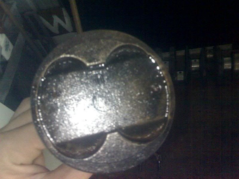

    can you take a picture of the top of one of the pistons?

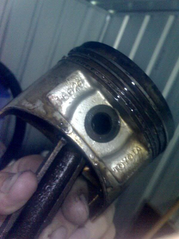

    take the other number on the piston (as well as 16020), plug into google = model of engine

    those look like 9.4:1 pistons. If it's only got the 18/40 bottom end I personally wouldn't even bother putting it back together. If you've got an intended application for it you're probably better off starting with a better base engine - ie smallport AE92 hi-comp.
