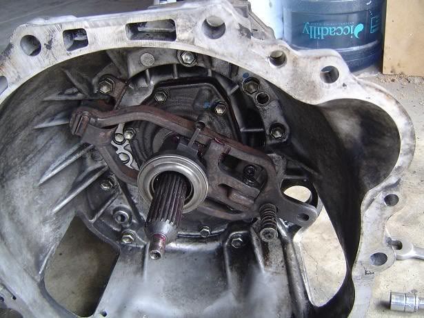

    so you have a small amount of free travel on the pedal and a small amount of free travel on the slave cylinder, have you had someone else under it while you try engage clutch, if its a "kit" does the "fork" have enuff movement sometimes you have to modify the pivot.

    Hm, that just looks ugly, but i think i can figure out how it works. Which is pretty simple, its just a leverage device. Best thing to do is to get a few torches out and look through the inspection window (big thing) and take photos of it with the clutch pedal depressed, at engagement point, half pressed,and fully out. That will help to show how much its moving. From what i can see though, that setup actually REDUCES the throw advantage. Which may be why screwing the adjustment stop all the way in and out does nothing.

    i can sort of follow what you guys are talkiung about here but i can honestly say i do not have enough experience with clutches to be able to adjust this correctly...i think its time to take it to an expert.
    Yes this is a good idea.
    I think it may have something to do with the pull - push kit, the slave cylinder/rod may be buggered and not giving enough pressure to push the assembly forward, or even could be the spring that pushes the clutch assembly foward, so taking some pics would help a lot. Also hopefully the clutch guys did a proper job in the first place and used some moly grease so the thing moves easier!
    Also the main reason I posted that link as it has other clutch resources and also you said the mechanic adjusted your clutch pedal which may of put it way off, probably not the cause of this problem though by the sounds of it.

    Well if your pretty sure the slave is fine and there is no leaks around it, I'd be looking at the master cylinder next, yes look for a external seal leak. Get someone to push the clutch in while someone looks at the reservoir, see if it rises or drops.
    Also how much resistance does that clutch have? Does it travel to the floor fairly easy? One thing I don't think that has been mentioned either is have you tried pushing the clutch fork with a screwdriver or similar to see if it moves? Just trying no narrow down things so hopefully you don't have to pull the gearbox out or pay someone else to do it! - I would help if I didn't live so far away

    the clutch fork moves and it looks like it moves fine...even when the clutch pedal is depressed...it just might be a few mm off...

    See how much freeplay there is in the clutch actuation mechanism. You should be able to see when the carrier bearing touches the throwout fingers through the inspection hole.
