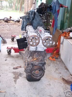

    Hey Hey,
    I picked up a bare 4age today. The previous owner said it was a from a Ae86, So it got me thinking is it a rwd bigport motor or is it a ae82 bigport turned rwd. I bought it as just a 4AGE bigport so i have no idea other than it has been rwd in its life as it has a spigot bearing and its old and doesn't want to come out.
    Picture time.
    4,626
    Default Re: I.D this 4AGE.
    Looks to be a 7 rib block. thats means a later model engine.
    Its very hard to tell unless you open her up and measure some things.
    well i cant tell anyway.

    Will be doing that very soon, In a few days when i pick up an engine stand off a mate.

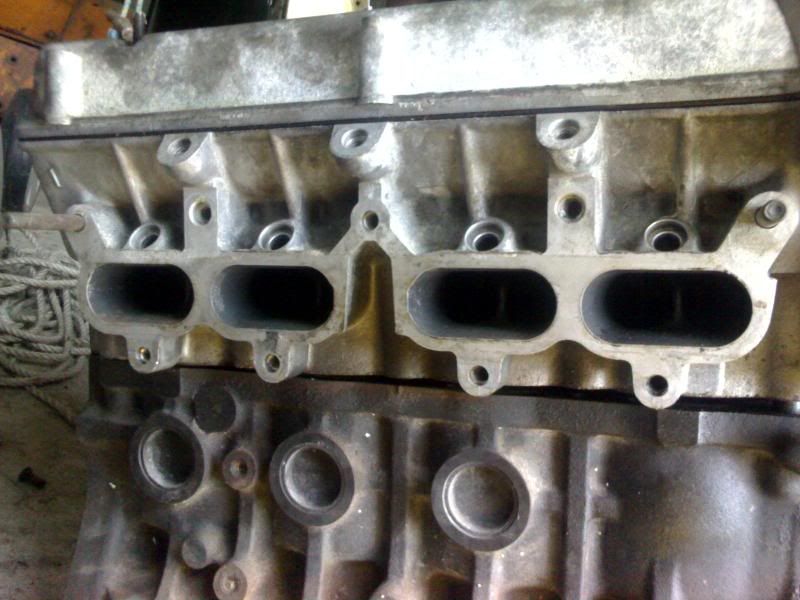

    Show a picture of the inlet ports

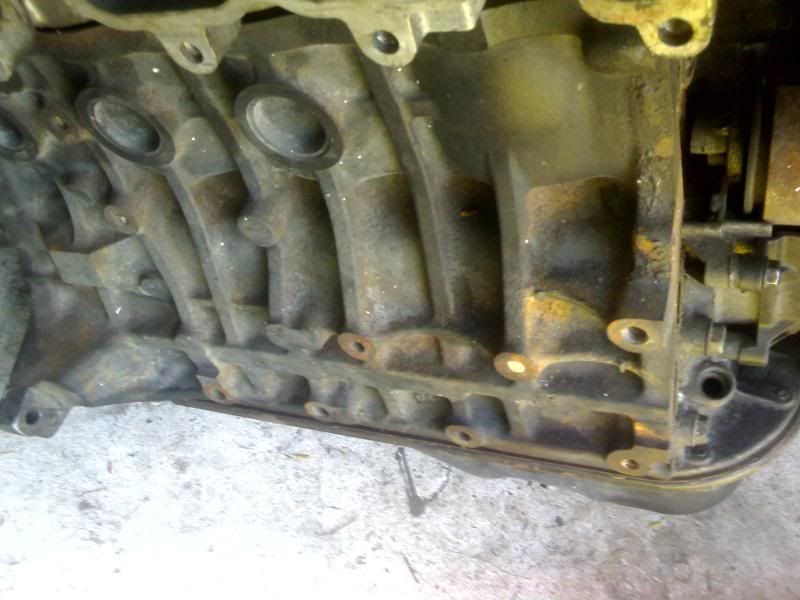

    yeah 7 rib block, do you want to know if it has been in a sprinter or if it was in one from the factory? if you dont have inlet manifold, water fitting etc then why does it matter?
    by the way, the cam covers are on the wrong sides
    EDIT:
    looks like a bigport head to me
    ae82 4age bigports were 3 rib, Some fxgt's had a 4age bigport 7rib, this is that motor
    Yeah bigport head 7 rib block.

    No manifold or water fitting, I know about the cam covers and will rectify it one day
    So 7 rib bigport it is, I will look for oil squirter's when i get it on the engine stand or maybe tomorrow when i want to get my hands dirty.
    Do rwd 4age blocks have the front engine mounts holes like ae82 blocks have ?
    1,182
    yep, which most likeley means it has 20/42mm conrods (big ones)
    So since its a 7 rib block it wont be an original Ae86 motor as they are 3 rib ?
    Any way of telling if its a Ae92 block with a bigport head or FXGT motor ?
    does it make any difference?
    all you need to know is number of ribs, size of bearings, big/little port, which pistons....
    Junior Member Domestic Engineer psychofox's Avatar
    697
    it also could be a AW11 block, as they were 7-rib. Note that no factory Bigport head block had any oil squirters.
