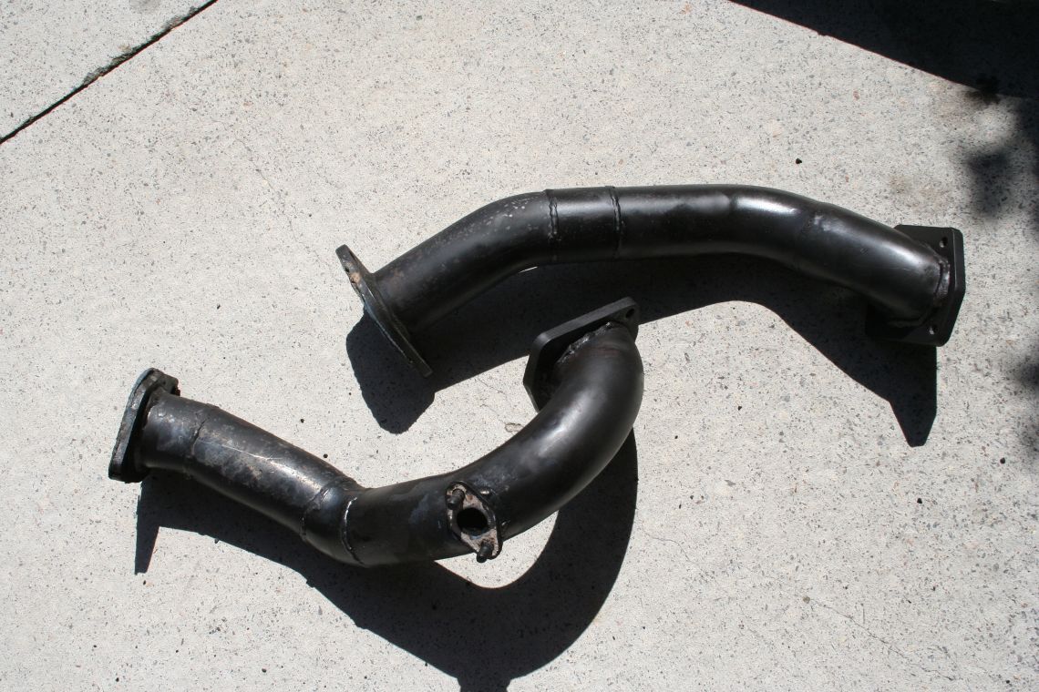

    jeez todd. thats some dodgy welding right there on the black dumps...

    Those Black ones look exactly like Lews Dumps? I installed some on my mates soarer....
    We spent a bit of time with a dremmel cleaning out the dags on the inside and also filling some holes where the weld didnt make it....
    The ones next to them look alot nicer though!

    the rough set were one of petes pipes prototypes, i didnt expect much for 300 odd bux am im grateful for his service and chance to test fit them.
    needless to say once i found they didnt quite fit i had another set tig welded up and a new jig created. i relocated the o2 sensor and used a slip joint instead of a annoying flange.
    both are mild steel.
