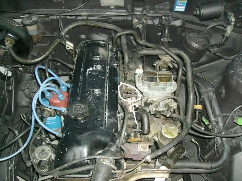

    is that the one your talking about
    its just got a bit of hose (1 inch) with a screw in blocking it

    Default Re: RA40 Rebuild and help page
    Na thats the vacumme advance for the dizzy. its next to there
    where the choke housing bolts to the carb the botom one of the 3
    right next to it there is a little hole

    oh yeah hosking it was that bit in the picture one I looked at it properly, but I dont have a tube coming off it so I think I will fill it with a bit of gaskit gue hope it dont fuck it.. fingers crossed
