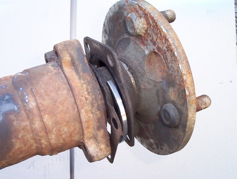

    spacer rings go between the St141 bearing retainer plate (which you shift over to your axles) and the bearings.
    axles are different i think - bog warmer not toyota diff.
    Also need bolts to attach the bearing plate/alloy caliper mounts to the axles tubes.

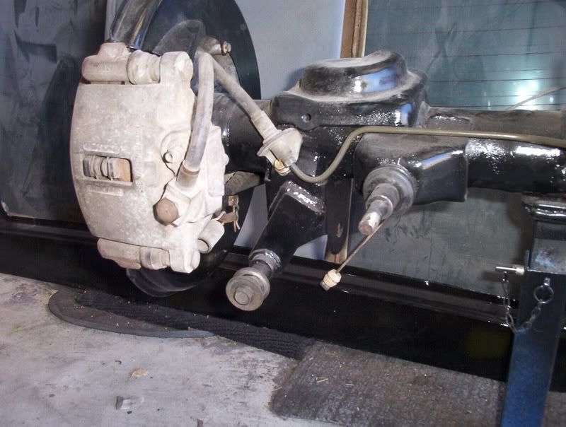

    Use the RA23's retainer, But you need the retainer ring's & bolts
    The ring go's between the bearing & the retainer plate..
    Also you will have to move you lower shocker mount as the shocker will foul on the disc caliper...
