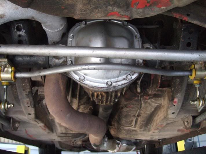

    Default Re: Puttin a Rear swaybar into a TA22 Help!
    quiter
    the link rods attach to the upper trailing arms.....they go from the top of your DIFF---------CHASSIS....
    you want to atach the link rods to the CHASSIS where the trailing arm mounts
    i need to see what the links bolt to any chance of a side shot?
    Hey mate found these ones, I believe they are off Rinmax's car:
    Hope they help...
    top is brackets that mount to chassis
    bottom is brackets that mount to diff
    http://img50.imageshack.us/my.php?image=1002077qk9.jpg
    You can do it yourself, it ain't all that difficult. Have a good look at someone elses car and do the same.

    1,852
    welding my arse
    drill 2 holes and the rest bolts up

    3,495
    buy a new whiteline bar, bout $150-$200 i think, comes complete with every nut and bolt, plus instructions for the NOOBS
