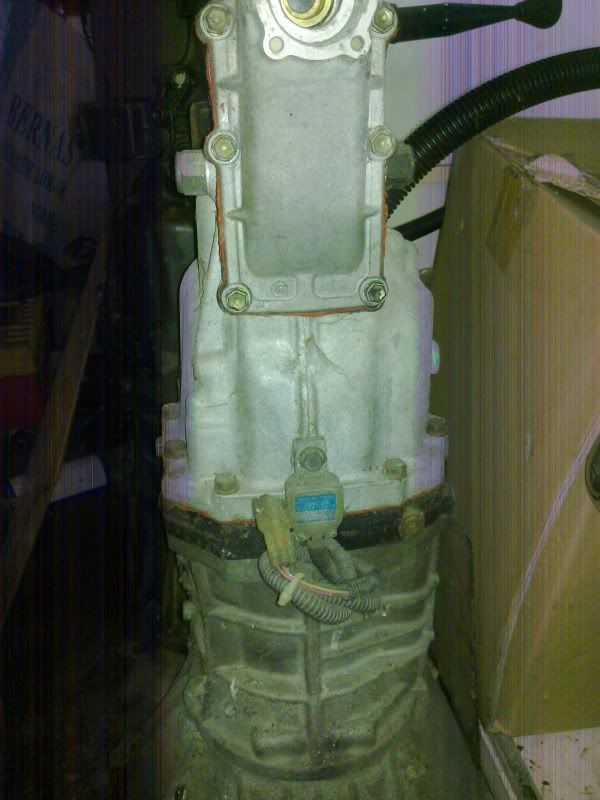

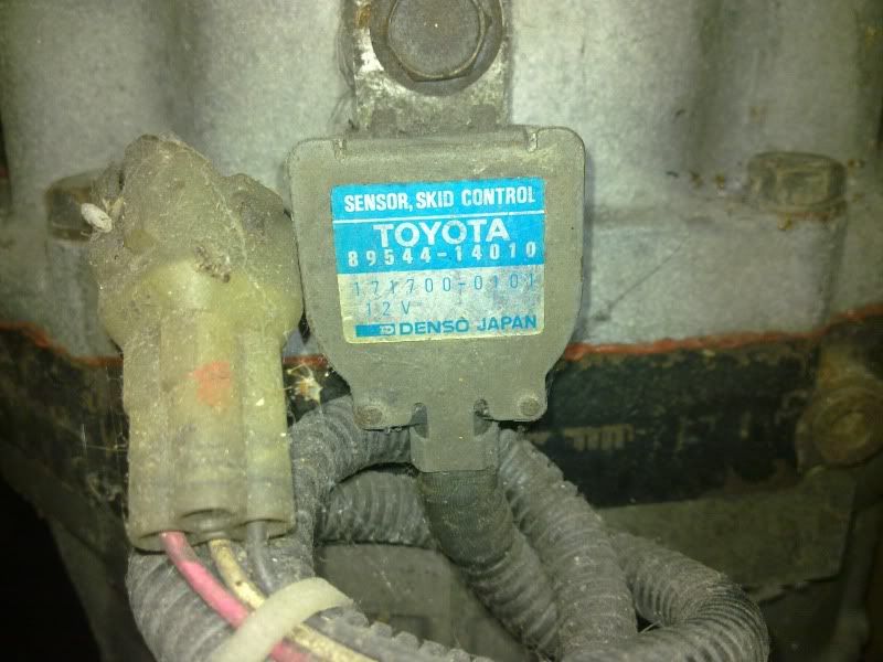

    I just bought a W5x gearbox. the weird thing about this gearbox is there is a skid control sensor mounted about 12' forward of the shifter hole. the seller quoted that this gearbox is from 7MGTE supra but I never seen any W58 with this sensor mounted.
    Any one came across one before?

    its not a 7mgte box cus they had R154
    1983 Toyota Celica Supra
    Perth, WA
    442
    Default Re: Skid control sensor on W58?
    So meaning that this gearbox is R154?? It looks identical with my other W55 though...
    Oct 2008
    TAS
    2,207
    i recon its a 7mge ma70 W58 gearbox, they had a sensor for ABS on the gearbox
    3,468
    Quote Originally Posted by CELICASUPRA7M View Post
    That would also be my suggestion...
    Actually looking the part number up in the EPC it says GA70 or GZ20
    Wilbo's JZA80
    Wilbo's JZZ12
    Perth, WA
    442
    then it could be behind a 1G instead of M engine...
