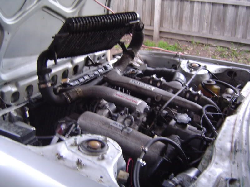

    Hey guys, did a bit of a marathon with a mate over the weekend aimed at getting the 1G in the 28 running. Im at work today, still a bit hungover, a tired twitch in my red sore eyes and to make things worse we didn't get it to run.
    Fiddly things took a while so we ended up dodgy fitting a lot of stuff in order to make it run. Ie, intercooer is sort of a side /top mount? Just using the high pressure pump (wired straight to 12v), filled the surge manually. Heater hoses just looped etc. Its ugly but theoretically should work.
    Turns over well, has power to the igniter. We couldn't find a spark. Injectors have got power, but only one constant 12v. Its at this stage we got too tired/drunk.
    Its possibly one of those things that is impossible to diagnose without going through wiring, i thought i would ask anyway.
    In theory, no sensors or units should be buggered, just more likely shitty wiring/connections. It ran well in the halfcut.
    Cheers.

    Is this the "t shaped plug" for the coil you can see here?
    Maybe ill keep the intercooler like this??
