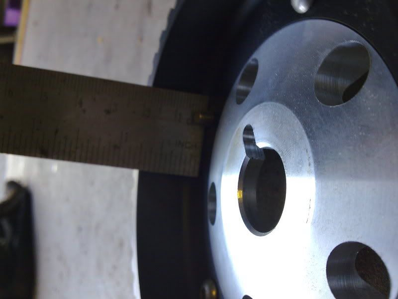

    Depth of the rear side is 14mm.

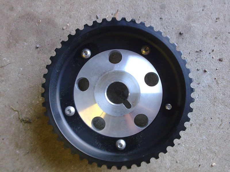

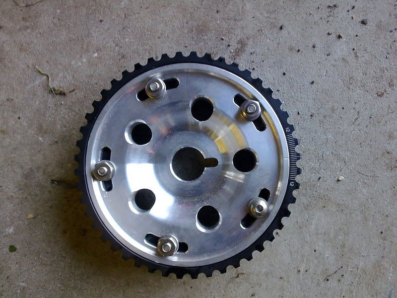

    Anyhow... here's the new one i picked up today.
    Notice how the recess is on the front instead of the back. Also, the dimension i indicated in this pic is now almost nothing.
    Bob (Autobarn guy) ordered it with the same part number that was on the box of the one i was given. When it arrived it had 1J on the box instead of 2J like it did before... and the gear inside was different. The thing is that it was the same part number. Who the F knows what is going on. All i know is that this new gear looks to be the correct one.
    Simon.

    Jabtronic... you beat me by a minute with your pics. Damn you.
    Thanks to all that posted advice and suggestions. I think i've got it sorted now.
    I wouldn't shy away from ordering a GReddy gear. Just be sure to check that the one you're given looks like the one i now have and not like the one i used to have.
