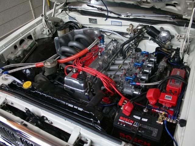

    inspiration
    not a 1g but still impressive
    1,452
    Default Re: carbied 1g
    that looks like an old 4M!! with a few mild upgrades... like polished cam cover, red spark plug leads...
