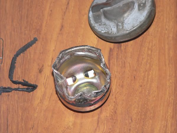

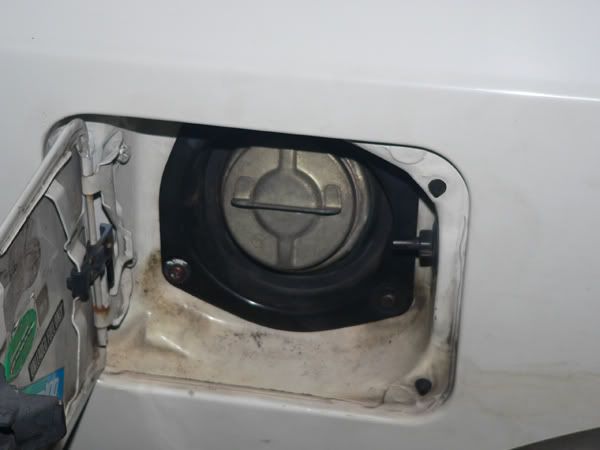

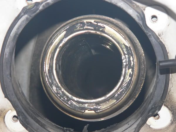

    Just to close off this thread, after some drama I did get the fuel leaking problem sorted.
    I ripped off the restrictor only to find there was no fitting for the leaded cap underneath:
    Luckily I was able to grab a whole new filler neck from TooF and install it, so leaking problem all solved
