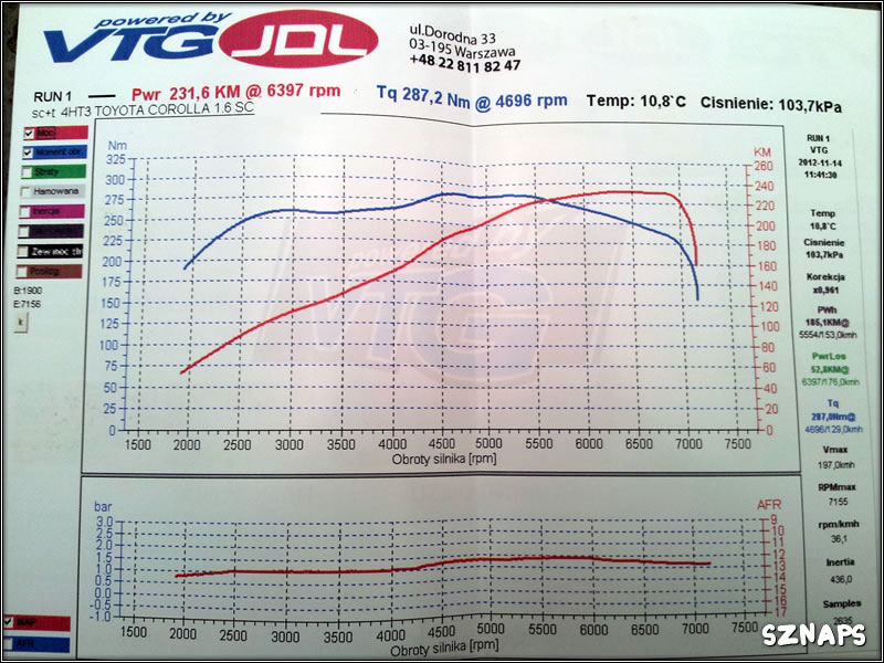

    Default Re: xA Series engine Variants
    Twincharged Ae82 4agzte
    KM = PS :-)
    Engine model and generation: 4agze from AE101 levin gt-z (so smallport. last gen)
    Top End Modifications: standard
    Bottom end modifications: standard
    Forced induction: Yes, SC12 supercharger + TD05 turbvocharger from evo X (TD05H-152G6-12T), 1,2b, supercharger turnes off before 6k rpm
    Management: EMU SA
    Fuel used: Pb 98, Pb 100
    Intake: Custom intake manifold
    Exhaust: 2,5"
    Driveline: E58 LSD transmission
