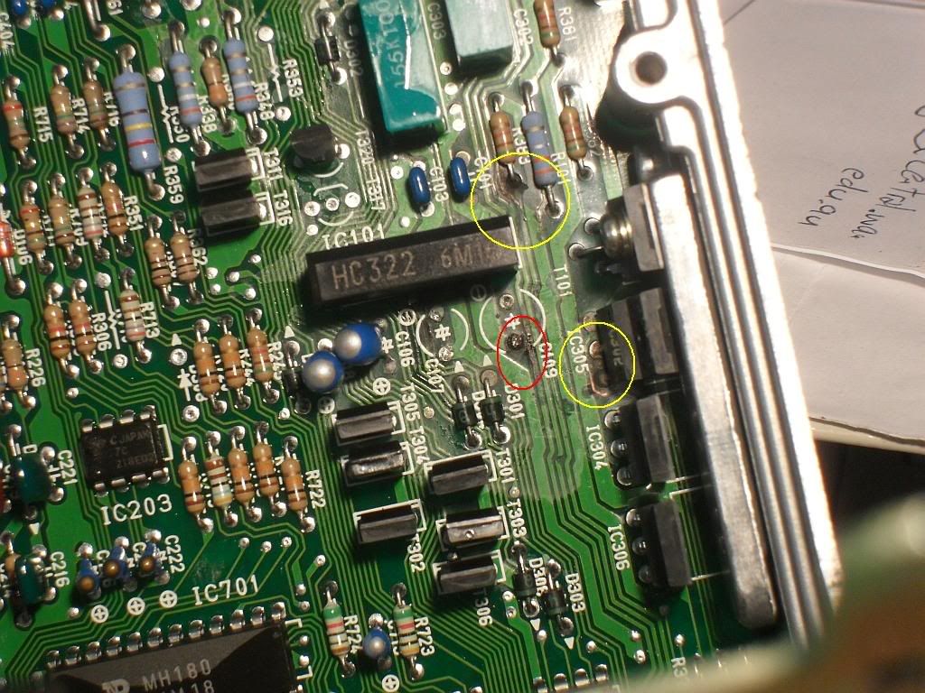

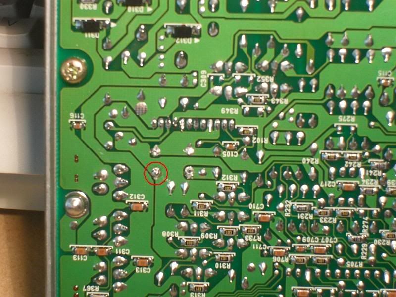

    Default Re: 1JZ ECU capacitor replacement info
    I had trouble removing a capacitor. The board looks burnt around the area I had trouble with. See the red section below.
    The areas around it also seem burnt (hightlighted in yellow circles)
    Can anyone tell me if I've killed this circuit board? Can I carry on as normal, or can I fix up something?
    I'm not sure if this bad area is from the heat or if it was there already.
    This is the best I could manage with the camera.
    Looks good from the other side
    Might be OK, best to just try soldering a cap on and see if it runs. You may need to run some solder along the tracks if they are broken in any way, to repair them.
    I found the best way to replace these is to get a sharp scalpel, and then cut the legs off the body of the capacitor, cutting as close to the capacitor as possible.
    This should leave you with a board with 2 legs sticking out of it, but no capacitor. Then clean away any corrosion if present with some circuit board cleaner, and solder the new capacitor to the old one's legs.
    For the burnt track, follow it both ways until you find a solder pad at each end.
    Solder a bit of wire from one to the other, effectively bypassing the burnt section.
    Alternatively, you could try carefully scratching the track back to bare copper on either side of the burn and using a short bit of wire (bare wire is easier to use, like a leg from a cap or resistor).
    I've done the same in an MR2 ECU and the thing worked fine.
    ECU seems to work.
    Hopefully if any problems arise from burnt tracks they'll do so at a good time.
    It would have been good to cut the caps off like you said Ribfeast.
    Thanks for the advice TERRA. If probs arise I'll follow through with that.

    1) Buy a 'solder sucker' from Jaycar, Dick Smith or ebay (10 to 25 dollars although they all look the same no matter what the price is). It is a sprung loaded syringe looking device with a teflon nozzle. You melt the solder and stick the teflon nozzle onto the molten solder and press the button. All the solder is sucked into the syringe body. You can then lift the items out of the holes on the board.
    2) With luck, the burnt board only has the protective varnish burnt and the tracks are OK.
