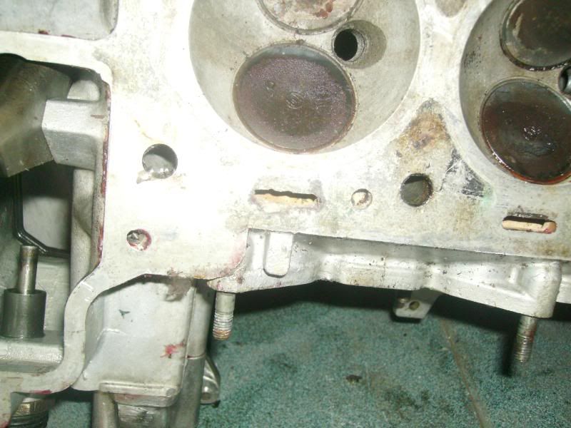

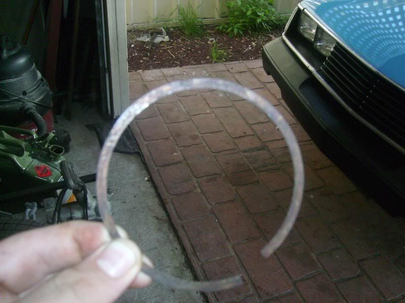

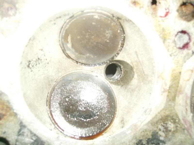

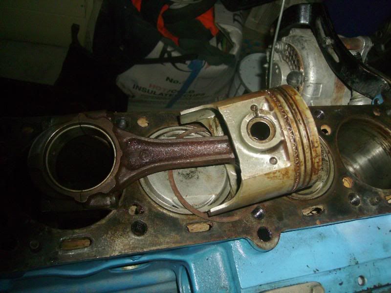

    ok well i have gotten the head off my 18rg (230 head).The valves appear to be the same as later 8825* head
    also the rings are rusted so when this was rebuilt it sat for a while but it must of got some water into the bores also theres abit of surface rust on the bores and conrods
    so i am going replace all bearings and piston rings gaskets etc the timing chains appear to be in good nick
    also the head will be sent away and properly serviced.i will also be going to get these checked out by a pro (see around the water galleries )
    have a good one
    luke
  7. #1057
    614
    I reckon those are 18RGEU rods (same as 18RC) and 88270 pistons, am I right?
    That corrosion is a bit weird, usually all th water ports need welding or all of them need no welding, you've got some some that are rooted and others that are mint.
    That just looks a little bit strange to me.
    Also, what's with the signature under the head? Do you know?
    Chances are that engine was build from spare parts and that's the rebuilders signature. They usually leave numbers somewhere to mark their work.
