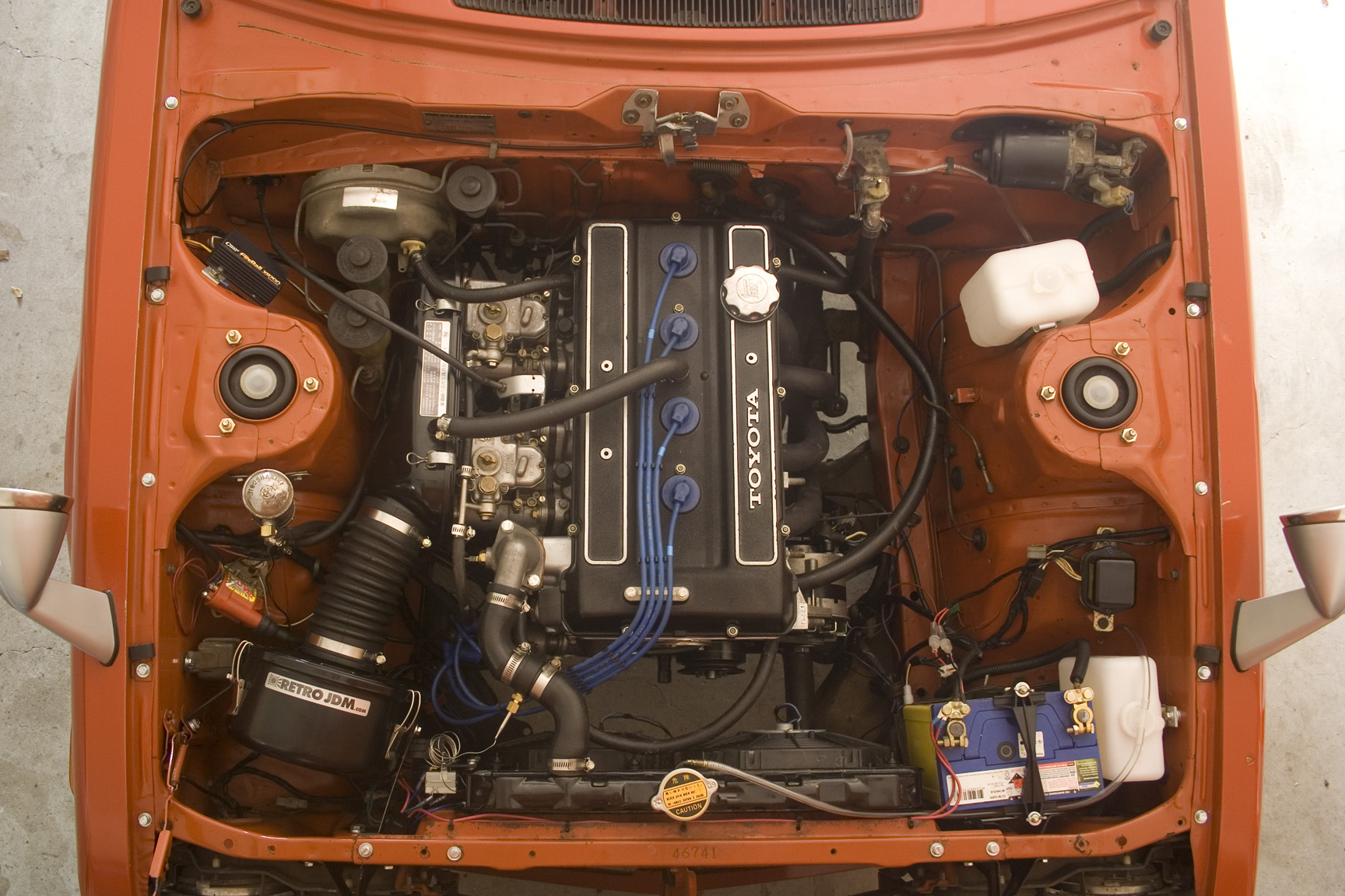

    Hey,
    In pursuit of that glorious induction noise, and keeping any mods I do reversible, I'm eventually going to swap my factory 18R-G airbox for either a:
    Pipercross PX500 or ITG Megaflow JC50
    Unfortunately neither of them sell a base-plate for an 18R-G. So instead of buying a blank one and making a mess hand-cutting holes...
    Does anyone already have one they could scan/accurately measure/dimension for me, so I can have one cut on a router with holes and all.
    Also...
    Does anyone have a short manifold (17111-88231) they can measure to confirm the carb center spacing? This old post comes close, but the +/- 1mm error has me a little unsure.
    I'd measure my own, but I'm feeling lazy and I can't be bothered pulling my airbox and ram tubes off - those little buggers are in there tight
