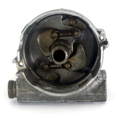

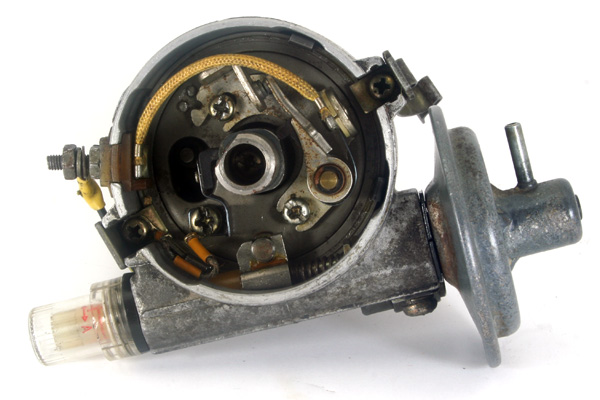

    I picked up two spare 18R-C distributors, both with the vacuum advance still in place. Between them, I now have options for 11.5°, 13.5°, 15.5°, and 17.5° mechanical advance (at the distributor).
    Points ignition (not being used) and vacuum advance.
    Mechanical advance
    I tried using the vacuum advance, but it seemed to stick. After servicing the breaker plate and vacuum mechanism to move perfectly off the car, I still couldn't get it to move any smoother with vacuum connected.
    After a bit more Googling, I found out that Webers don't like vacuum advance (I have twin 45 DCOE 13's).
    I tried a few combinations, and have settled on 15° initial advance, 23° mechanical advance (for 38° total, which is achieved at around 2500 RPM) and no vacuum advance. I've used the original breaker plate from my car that couldn't rotate.
    I think I've got it as good as I can for now. The next step will be to take it to the carb guru, but that will have to wait a while. Real life is getting in the way
