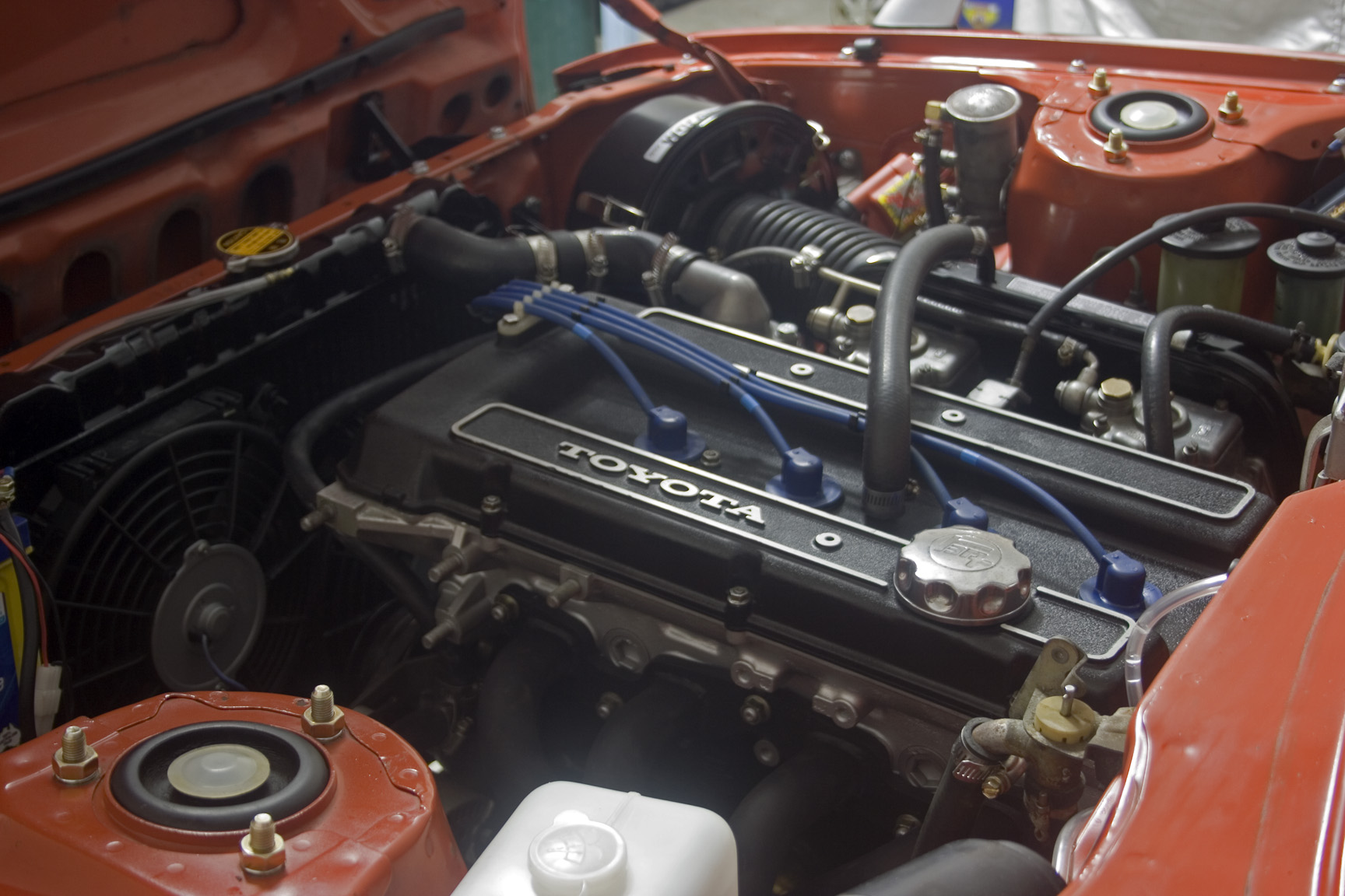

    I thought I'd share these two photos here, and take this opportunity to give a massive thankyou to stidnam for sending me the Oil Nozzle

    That is a beautiful engine.

    Quote Originally Posted by andrewzuku View Post
    I was admiring your ride yesterday mate, very jealous and very nice work! Love the top down engine bay shot.
