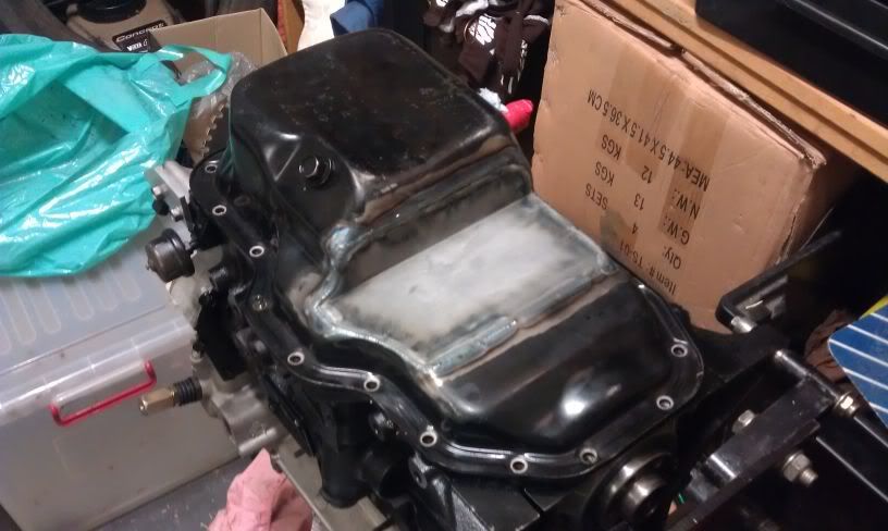

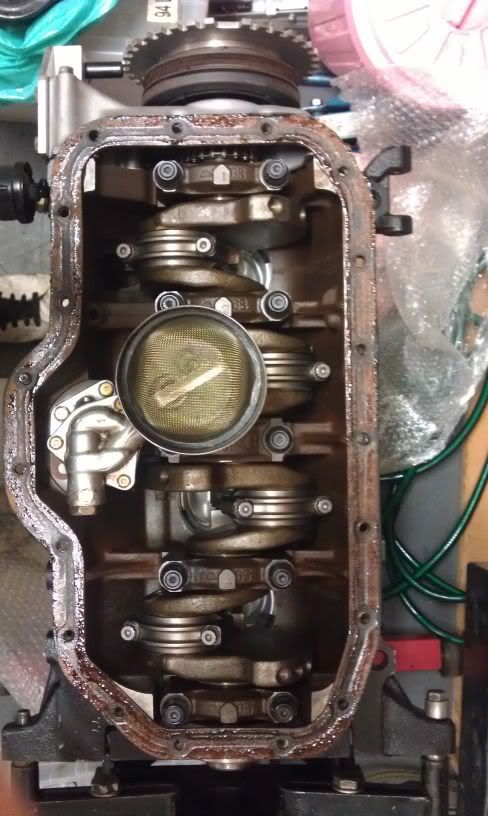

    i can only comment on what im going through with putting an 18RGTE into a KE70 with AE71 crossmember.....
    ... its not exactly a best fit.
    Have had to modify the front sump to make more clearance for the crossmember.... cos the oil pickup is still rather "central" to the engine as opposed to way forward.
    See pics below.
    ...... butt scratcher?!

    So the pickup should work but more clearance required on the sump might have to blot it up to one of my bare rcs and take a few measurements
