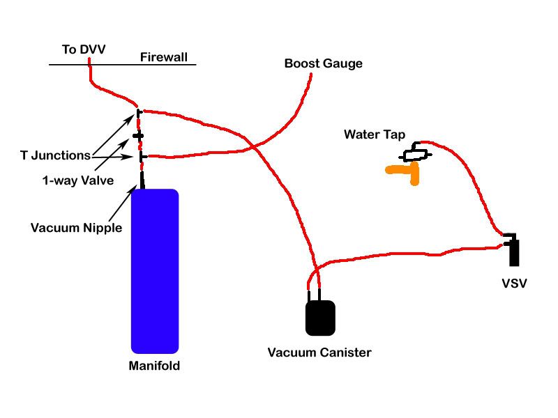

    This is how i hooked up my vacuum hoses.
    Sam
