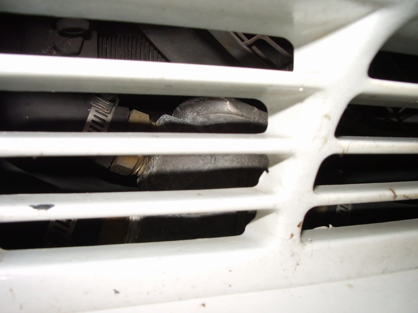

    Speaking of which, i still can't seem to upload my photos. If you're getting impatient, go to www.perma-cool.com and picture a 10189 fitted snugly against my ac condensor behind the front bar of my sx, and a 1070 mounted inline just after the lines from the sandwich plate pass through the radiator support.
    Besides, without me pulling the headlights, trim etc to get the bar off its not overly clear and pretty. I'll continue to butt my head against the photobucket wall for you lot, unless somebody wants to put their hand up to host and i'll email them?

    But, photobucket decided to play fair! It's probably not really worth the buildup now, as i said earlier, not the best photos; at night, trying to wedge camera in tight spaces lit by the light on my mobile... but you get an idea.
    'cooler;
    http://i5.photobucket.com/albums/y15...to/cooler1.jpg
    http://i5.photobucket.com/albums/y15...to/cooler2.jpg
    http://i5.photobucket.com/albums/y15...to/cooler3.jpg
    sandwich plate;
    http://i5.photobucket.com/albums/y15...wichplate1.jpg
    http://i5.photobucket.com/albums/y15...wichplate2.jpg
    thermostat;
    http://i5.photobucket.com/albums/y15...hermostat1.jpg
    http://i5.photobucket.com/albums/y15...hermostat2.jpg
