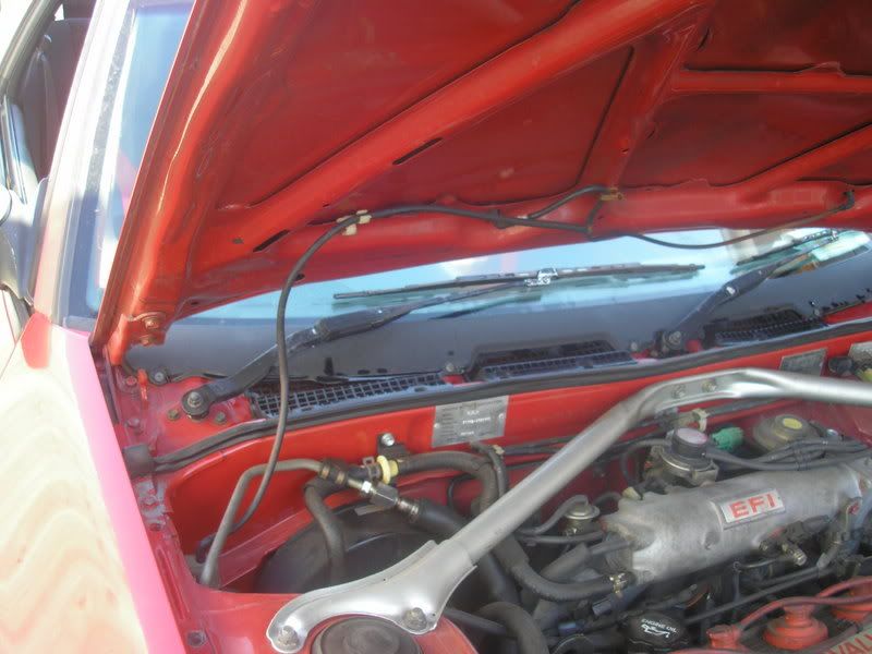

    bout to put a new st162 i just bought in for a roadworthy at 9am tomorrow morning and the washers aren't working on the front windscreen....
    i've worked out what the problem is... when the bonnet is up, they work, when down they dont and i've noticed that the cable that holds the water gets crushed when i close the bonnet
    i've got pics to show what happens exactly and i'm wondering what's different in other people's st162's that would make the not happen...
    i'm sure i could manage to get it straight with some stuffing around, but i dont wanna have to do that every single time the bonnet is open and closed...
    here are pics

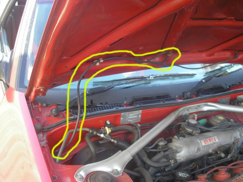

    this one shows the cable surrounded in yellow that i'm talking about.

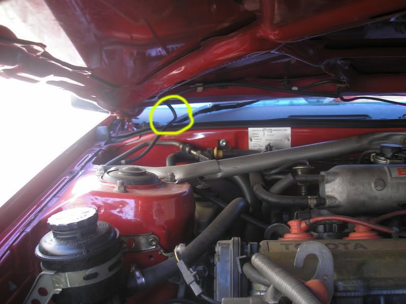

    and this pic is when closing the bonnet, you'll notice the cable bends itself and crushes when bonnet is closed

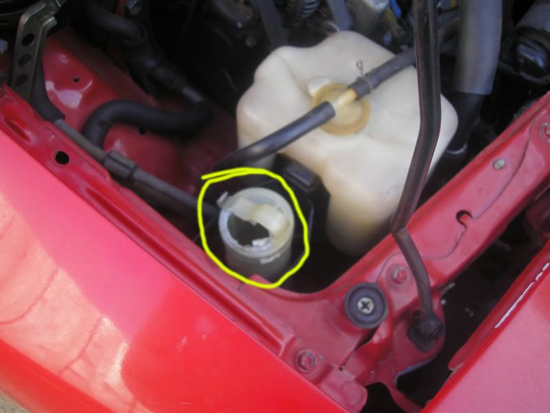

    this pic shows the water bottle... i know the cap is cracked, but could someone shed some light... is this actually the size of the washer bottle?
    cause it empties so darn fast... i'm used to the bottle of a ta22 similar to the size of the bottle next to it in the pic.... must be a pain having it go so fast?

    ok... i've taken out the cable in question and turned it around as it seemed to me it was hellbent on bending that way...
    it now bends properly... only prob now is that the other end is loose and worn and pops out of the squirter end and starts squiring water inside the engine bay....
    will have to source another one of these... can they be bought brand new? something that a bursons auto shop might sell.?
    still wondering bout the water bottle though... goes through water way too fast

    the T piece is running the wrong way for that washer hose, it needs to be rotated 90 degrees
    get some new hoses for it for the couple of bucks it costs from super cheap then the hoses won't pop off anymore
    there's also a one way valve type thing which I think is in the wrong place in your system, looks like it's just next to the drivers side squirter instead of being before the T piece
    the washer bottle is reasonable size, there's a larger part of it down below that neck... it would hold more than a ta22 washer bottle. I only have to fill mine up once a month or so.. just get another one from a wrecker or even better if possible just the lid from a DIY wrecker, brand new would be financial suicide and parts stores like bursons etc won't have them

    i may need a diagram to know what your talking about?
    i duno what the T thing is
    and i duno which valve your talking about
    in regard to the washer bottle... something strange occuring, i dont think there is an extra bottle underneath in mine, cos as soon as you begin to squirt it begins to go... i figured that at first but when the little bottle is empty there is no mroe water in coming out?

    T piece, connector that looks like a T which splits the pipe into two....
    The washer bottle doesn't have another bottle below it, it's all a part of the one thing... are you sure yours doesn't just have a crack in it and is leaking it out?
