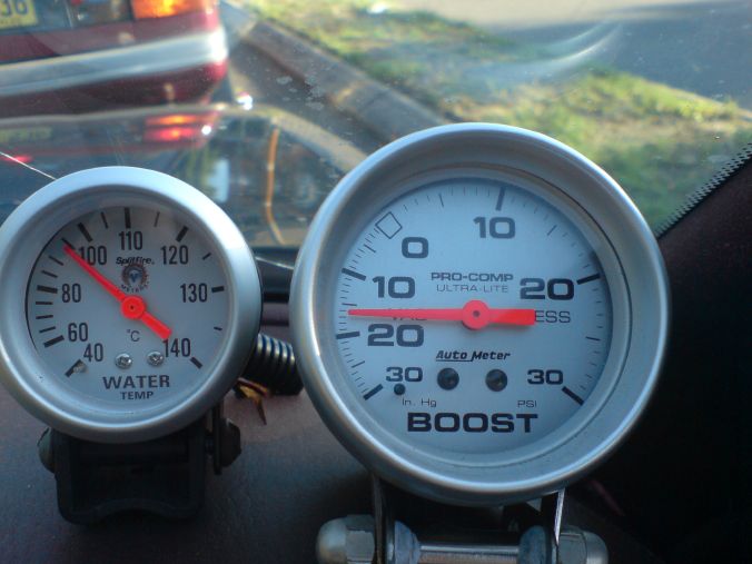

    So an idle vacuum of around 15psi on a 1JZ is not so crash hot? This is at 630rpm, snapped it while in D, waiting for the traffic lights to change.
    Wouldn't a higher figure give you better throttle response?
    Compression is around 167-175 approx across all cyls.
    244rwkw / 328hp @ 18psi
    Default Re: Stock fuel pressure on 2JZ and 1JZ
    engine under load in D - you really need to see the pressure in N or P with the AC and other ancillary stuff off.

    Hmm I'll give it a shot It sits in the 20's when I'm coasting down a hill at medium speed with my feet off the pedals...
    Does vacuum have much to do with throttle response? You would think the closer you are to boost or positive pressure at all times, the better right?
    for a start.. the gauge is Psi on the RHS, and inHg on the left hand side..
    second. 1 atmosphere is 14.7psi.
    it is very hard to go below 14.7psi.... in fact it is impossible
    say (roughly) 1atm = 101kPa... our vacuum furnaces go down to about 10^(-8)kPa (ten to the minus 8 pascals), but that is still not less than 14.7psi vacuum
    in absolute kpa, idle could be from around 30-40kPa to 60-70kPa (unless you have huge cam and ITB.. then higher), and on decel, could go down to 20kPa or so...
    Hmm so if I had my boost gauge referencing from around the exit of the turbos, it wouldn't see so much vac? I guess the throttle body would be a huge restriction when you let off the loud pedal, hence the vacuum reading...
    you would only see vacuum there if the engine was trying to pull more air than the turbos could provide (WOT from idle maybe?) but not much..
    throttle body IS loud pedal .. and engines usually are sucking against a vacuum....
    ie, manifold is always in vacuum, unless you have pedal pressed down far enough to go to atmospheric pressure (WOT for NA), or boost (less than WOT for FI).... unless you are pushing pedal enough to be WOT for NA or more (for boost), then the manifold will ALWAYS be in vacuum....
    unless it's a diesel
    oh, and the whole point of throttle is to be a restriction.. otherwise you would be at WOT all the time.. fun but.... (diesel engine speed/power is controlled by fuel, not air..)

    Thats good info man Make sense now that I think about it.
    Here's my vacuum in N or P:
    Does that look OK, or should it be lower?
