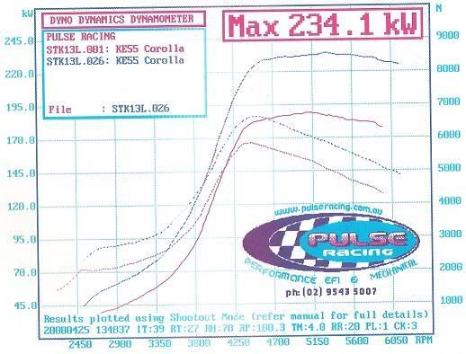

    Ok guys its all on the trailer ready to rock tomorrow night!!!!!! im actually a little nervous
    Would hate to run a 15...
    I drove it back from menai to blacktown today which is about 50km or so and man that thing is a weapon on the street could only get traction in 4th and 5th with the 14's on there
    Here is the DYNO SHEET
    and tomorrow ill put up the time sheets or maybe the next day depending on how good they are....
