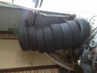

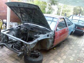

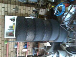

    Sweet, yeah i might need that.. Hopefully i will be pulling my engine out soon, just gotta clean up my bros place so i can fit my car in, then i can get started and get your intercooler pipe and cooler back to you..
    Sorry for having it so long, my plans got put on hold for a while when i went back to uni..
    Here is what i have to deal with at my bros place..
    he is building himself a dedicated drift car and we still have a lot of half cuts to clear.
    Stomps
