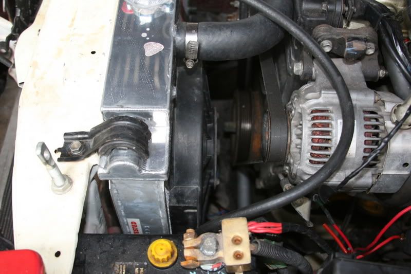

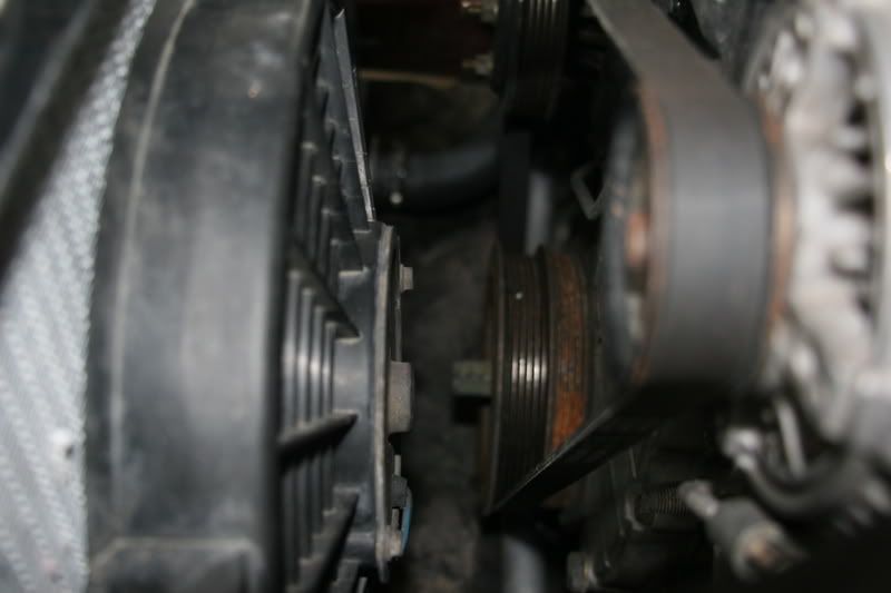

    Got out the measuring stick to tightest point ie where the crank shaft pulley slips onto we have an amazing 70mm of room .
    The problem its a chunky biatch.
    If in doubt power out
    606
    Default Re: Thermo fan options
    whats wrong with that? The thermo clears the crank pulley. Or have i missed something?
    7,493
    Quote Originally Posted by Pube
    Theres another thermo fan that isn't on there in that picture that doesn't clear
