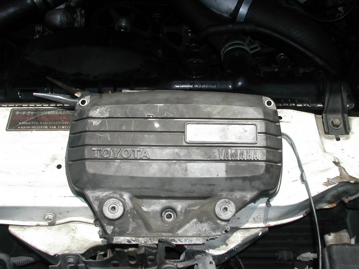

    i didnt get to take the cover off yesterday as it was too hot and i wanted to goto the beach .
    anyone know if i take the cover off today and dont get it back on by the time i have to goto work , if the 1G is fine to drive without the cover?
    i see all the show car 1JZ without the cover on all the tiem , but i wanting to know if the 1G is the same

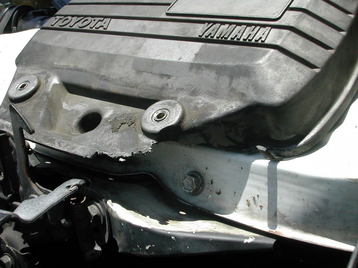

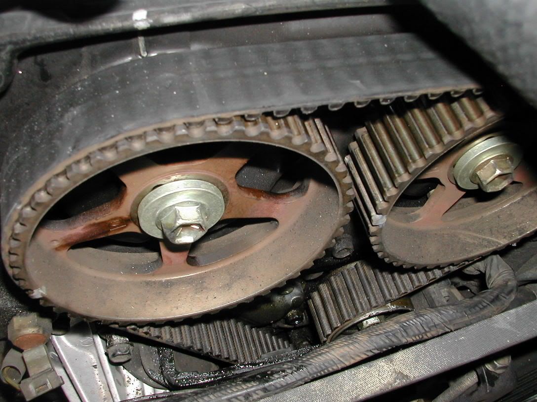

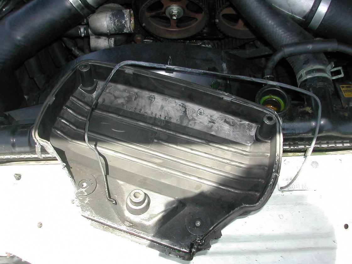

    Well , when a timing belt cover is not bolted down properly you get the noise ive been complaining about ...
    as i said ill take it off and see if there is a problem with the belt ... what i found was this ..
    the belt on there is BRAND new , looks to have done under 10,000kms for sure
    the Cover however is fadoodled ... looks like yet another thing to purchase due to the last owners carelessness with the old girl ...
    oh well guys , i hope the problem is solvered for now ..

    Oh and that seal you have there, considering their age, they start looking old and get hard. I found small vacuum hose jammed in the channel works perfectly and squishes down well. The updated versions of the factory cam cover seals are very similar.
