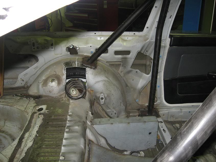

    heres some of nztoygt's pics:

    yeah we did that so it could go lower and not hit
    i'll post some pics with the wheels and flares on to show how low it goes

    sounds good, which diff are you using?

    far out that's a pretty damn special job there
    How different does it handle now?

    i'm using a g series with a powertrax locker diff
    i will know how it goes soon the motor is being assembled in new year and the
    vertical shifter should arrive about the same time
    as for the watts making a difference a few of the race guys over sugested it and they seem to think that it will make a difference

    yeah, the nose of the diff hits on a well slammed hachi. pretty common "problem".
