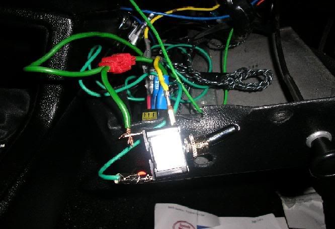

    Here's a pic of the switches and the wiring that came with the car when i bought it...

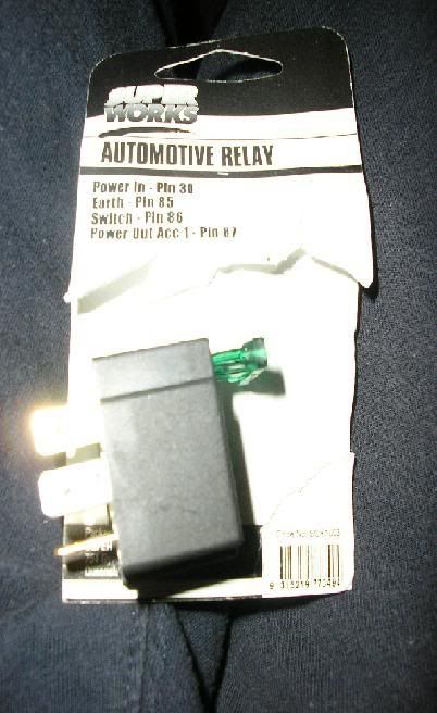

    The fuse holder:
    What should i do? Do i wire up the fuse holder and put the positive wire from the neon on the power input and the negative on the power out?

    The easiest place to find power controlled by the ACC position of the switch is the back of the cigarette lighter. There's normally a 2 pin connector joining the cig lighter into the dashboard loom just behind the lighter.
    The "fuse" you've shown above is a relay. While I don't know the current draw of a neon, I suspect it's not huge, so the relay shouldn't be necessary.
    I'd simply join into the +12V at the connector in the wiring to the lighter,
    then the fuse
    then the switch
    then take a separate wire to each neon and bring both negative wires back to the same point for earthing (makes fault finding easier)
    Good Luck

    Yeah the fuse holder you have is also a relay, however if they have fuses in them already the fuse holder isnt neccesary.
    There is two wires on the light. One 12v positive and 12v negative(otherwise known as earth).
    You need to find out which wire is which firstly. Hopefully in the instructions it say which one is which. If not you will need to plug it into the cigarette lighter, and put a test light or multimeter on the wires to find which is positive.
    Then you connect both positive wires to ones side of the switch and the other side of the switch to the Accessories.
    Then the remainding wires off the light get joined together and then bolted to earth.
    Dont stress just think about it, and if your not sure come back and ask before you do it.

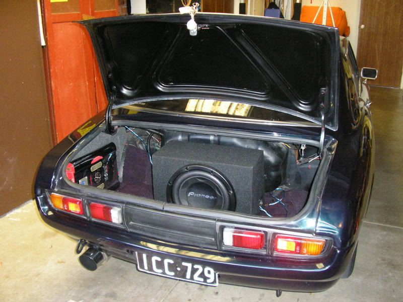

    Heh, my stereo seemed to be pretty easy, minus a few question i had 2 ask. Now its running 6" xplod speakers in the door, 6x9 JL audio speakers in parcel tray, 15" sub, hooked up 2 seperate amps.
    Anyway enough showing off lol, thanks again.
