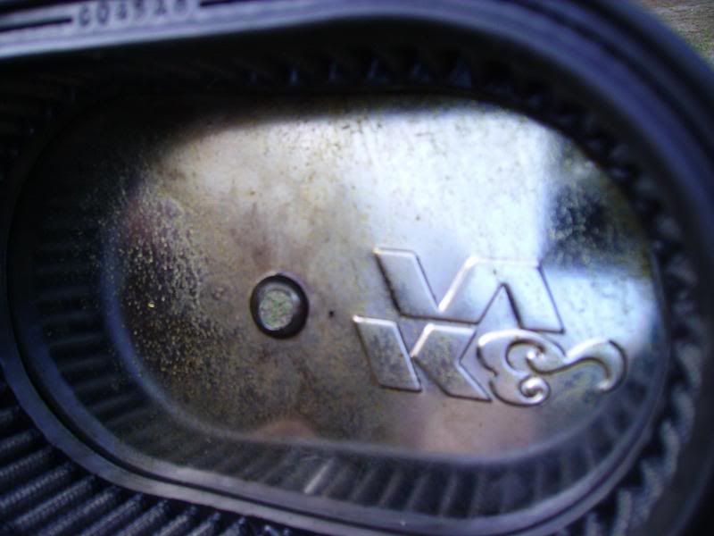

I started the car and was backing out of driveway and it started to idle real low so i thought it just might need a bit of warming up so i took it down the street, felt a bit funny, and when i stopped and it was idling it was slowly just idling lower and lower and cut out within a couple of seconds. Went to start the car again, fired up ok but within 3 seconds and pumping the throttle it just died out again. Now when i try to start it it cranks but it won't fire up(put foot to the floor just incase its flooded for some reason but still wont fire).
I had a little muck around with the fuel mixtures (did the turn to the end and then wind back 6 times) and still nothing. Checked the dizzy cap, when i took the leads out of each of their caps there seemed to be a fair bit black carbon deposit stuff which i blew out of each but still nothing, so i swapped the leads with another set and still nothing!
Also found this, air filter is only about 2/3 months old:
http://i99.photobucket.com/albums/l2...i/PICT0065.jpg

Why bother going to the same place again? It's obvious they don't know what they're doing and have done a poor job the other times, so why give them another chance?
Find someone who knows what they're doing, regarding these old carbs.
Failing that, buy the carby kits yourself and send a PM to Rodger, who knows these old carbs. I'm sure he can talk you through anything that confuses you. Also, if you search the threads you'll find a thread I put up that shows how to tune your 18R-G/2T-G carbs.
The biggest problem with these old carbs is they are a bit finnicky to get set-up properly, but once done you'll love them.
Of course, if it's all too much you can do what many others in these forums, who have found the technical challenge of carbs to be beyond them... is to whack on an EFI system and then tell everyone how much better EFI is over (worn and badly tuned) carbs!

That is what i was thinking this morning river, so i rang up a place that i got reccomended to and has worked with solexs, but yet when i told him about them he doesn't want to have a thing to do with them and won't agree to working with themWhy bother going to the same place again? It's obvious they don't know what they're doing and have done a poor job the other times, so why give them another chance?Ended up ringing my local mechanic for advice and he has a connection to a guy who works at Melbourne Performance Centre in bayswater who is willing to have a go with em, so fingers crossed.
