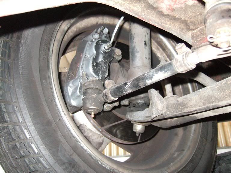

    yeah my arms are mounted down,
    heres a pic from the inside,
    and yes, i want to redo thise brake lines, make a complete braided line,

    if you use brake lines from a ra60 i think, they are perfect lengths. all flexible too. but new ones would be much better off. all connections same for a ke30, prob same for everything else.
    i think all toyota brake connections are the same, but i know that the SKYLINE 4 pots fittings are differnt to toyota...
    just incase anyone is using the skyline 4 poters
  9. #99
    6,193
    Default Re: [Guide] Corona/Peugot/Hilux Conversion with Height Adjustable Coilovers [56k DIAF]
    Some Toyota calipers use the nut like in your pic and some use a banjo fitting.
