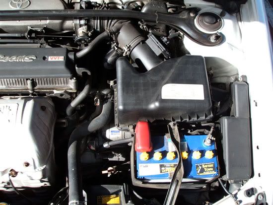

    The PITA thing about the beams airflow meter, is that it looks like this:
    and often doesnt come in the pipe that it should. (Which is what happened to me)
    The factory Caldina ariflow meter is positioned here:
    You can see that it's in the first part of straight pipe, just after the airbox.
    I wonder if the airbox helps dampen any pulses or reverberations that might upset the reading that it gets?
    Here's my setup:
    My engine was converted to a MAP sensor when I got it, so I had to buy the AFM, and then mount it in the pipe that was included.
