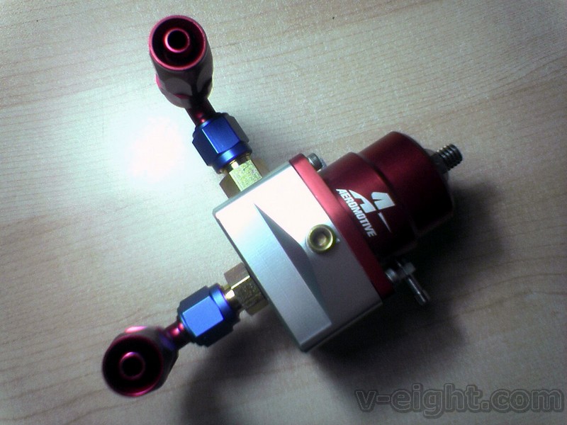

    2,537
    Default Re: Malpasi fuel pres reg. noisy?
    aeromotive
