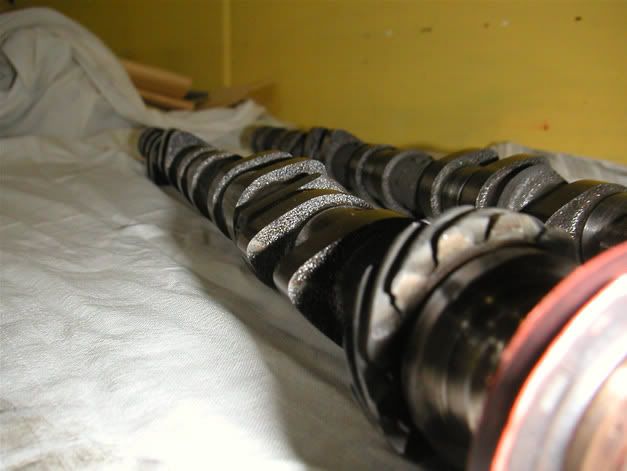

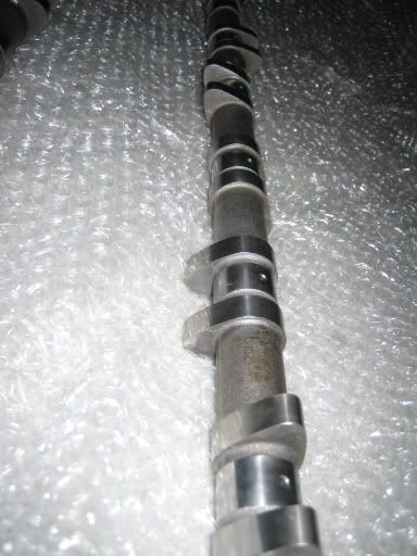

    Yeah, the guy selling just posted pics. There's no way those puppies are anywhere near 272 duration!
    http://www.supraforums.com.au/forum/...ad.php?t=23048
    Just for comparison here's my 264 duration group A cam
    And his Turbo A cam
    I'm 99% sure his is a standard 7M profile cam

    100% that the Turbo-A cams are no different then the latter 7M`s

    Turbo a has standard cams.
    TRD GPA also made 288, I have them.
