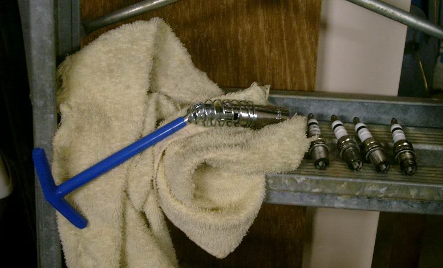

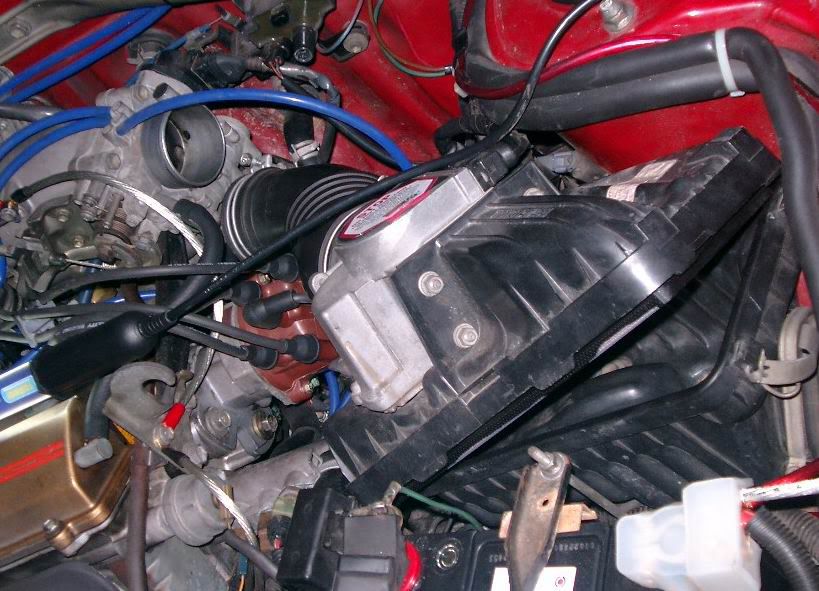

    Time to see if I could get rid of this ping. I've been told the pinging in an engine can be caused by the compression in one or more chambers being too high, thereby increasing the chances of pinging by igniting the fuel before the spark can ignite it.

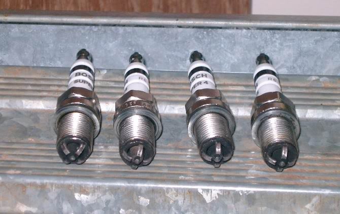

    I removed the plugs to check their condition, which was fair to average on most of them, but #3 (not #2 as thought before) was looking darker than the rest.

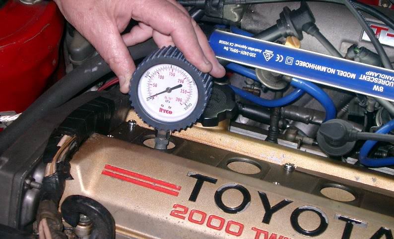

    I wanted to do a compression test on the cylinders to see how they were fairing, and a procedure had to be followed to do this...
    - remove CDI connector (above coil lead, held in with a clip, black and orange wires)
    - remove coil lead at one end
    - disconnect air hose from throttle body, but keep AFM connected
    - remove connector to cold-start injector, located on the throttle body
    So, starting from #1 cylinder (as pictured, closest to the alternator belt), make sure that the rubber plug is seated into the spark plug housing and is secure. The compression tester gauge stem is long enough so you don't have to remove the rocker cover. You'll need to have someone turn the key on the ignition for about 3 or 4 cranks. You may hear the engine pop a bit. When the gauge doesn't move anymore, stop cranking the engine. Write down the reading that your individual cylinders produce in PSI (pounds per square-inch, or lb/in2, or in KiloPascals (kPa). Most people use PSI.
    So after the readings are all taken, plug the spark plugs back in, distributor leads, CDI and coil lead all reconnected. Re-seat the air tube back onto the TB, lock the airbox back into place. Plug in cold-start injector and the restart the engine.

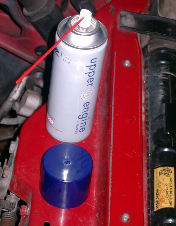

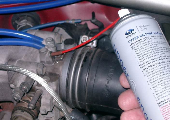

    Earlier I went and got some Upper Engine Cleaner from Subaru, having been told that this stuff works wonders on engines of all sorts. Now since you can't actually spray this stuff directly into the throttle body butterfly due to the air hose to the TB being connected to the AFM, if you try to remove the air hose from the TB while the engine is running the car will stall. So I needed to find another way to get the can's contents into the throttle body somehow.
    By removing the vacuum hose of one of the VSV's, I could get the tiny nozzle supplied with the can of Upper Engine Cleaner into the vacuum nozzle. Directions are:
    1. warm engine to normal operating temperature (done)
    2. with ignition turned off, remove convenient vacuum hose (doesn't say which one) from the intake manifold and spray approx. half the can into the manifold using the nozzle supplied with this can.
    3. allow the engine to stand for 5 minutes.
    4. start the engine and run fast enough to prevent stalling while spraying the remainder of the can into the manifold. (this was a bit tricky, trying to keep the engine's revs up while spraying the can into the manifold)
    5. stop the engine as the can empties and allow to stand for 5-10 minutes.
    6. restart engine and rev engine to purge any remaining foam.
    7. reinstall the vacuum hose.
    8. road-test vehicle to ensure good performance.
    9. extremely dirtry systems may require re-application.

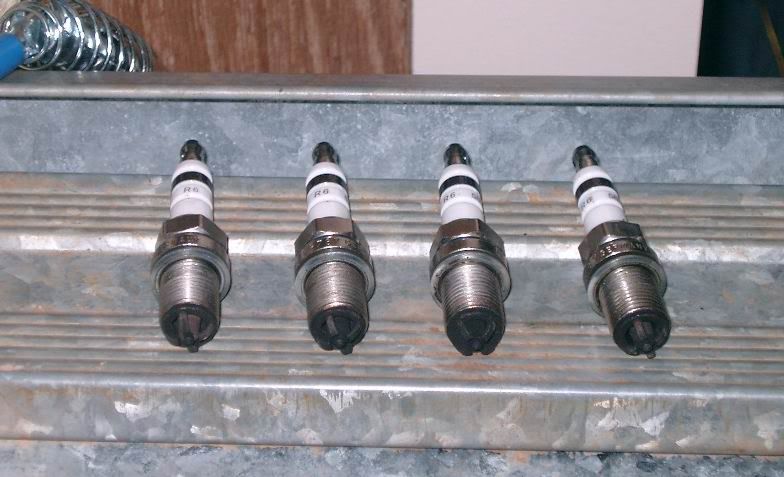

    So having followed steps 1 through to 7, here's what the plugs looked like after the process...
    Got any blacker?? The #3 cylinder was a bit of a concern as well after I removed that plug, because the plug hole started releasing oily smoke immediately after removing the plug. I shone a torch down into each of the cylinders, and the best way to describe it was like looking at charcoal. I'm just wondering what benefit this can was supposed to provide. To add insult to injury, the compression didn't change (even marginally) after the treatment was put through it.
    I couldn't in good conscience put those plugs back into their respective cavities without at least trying to clean them up a bit first. I got out the Metho and an old nail file (a bit of emery paper will do), and proceeded to lightly cleanup the plug surface. The electrodes were the worst, but I gave the core/tip a light going-over as well. So above is the end result of that.
    Results: Each cylinder's compression was rated at 1034.2kPa (150 Psi), which is slightly down on factory specs (between 1080kPa (156.64 Psi) and 1275kPa (185 Psi)), which is within the 100kPa tolerances on this engine's specs, but still doesn't explain the pinging.
    So, going by these results, I'm no closer to finding out what's causing the pinging in my engine under light loads, except for that anomaly with cylinder #3. Just seems a bit bizarre...
