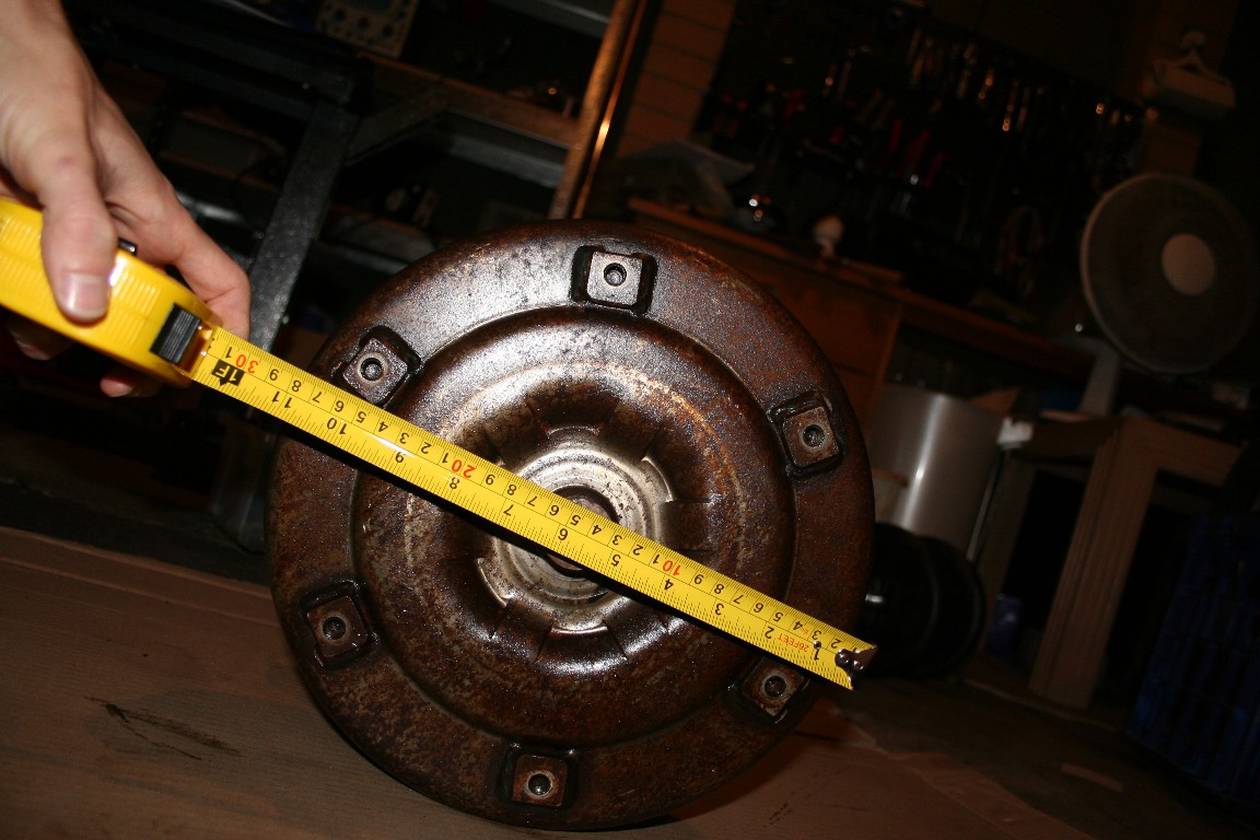

    Awesome thanks Joel. Which group of splines did you count? At the top or bottom when looking into the converter?
    This is all getting a bit confusing I really need to get my gearbox back out of the car to see if my converter actually matches the box!

    Default Re: Stall converters for A340
    yeah at the top, the converters still have fluid in them so i can't see the bottom set
    i am sure your converter would match it man, if it fitted it, it matched it, my theory

    Quote Originally Posted by 2JZR31
    Mine is from an A340E Aristo.
    38 spline outer (could be out a spline or 2)
    20 spline inner (could be out a spline or 2)
    dude did you count the splines in the converter, or on the gearbox?
    the converter has gaps where there are no splines, cause my input shaft from the box has about 38 splines, and 20 for the smaller one

    Quote Originally Posted by wiso
    Never fitted it, so don't know thats true.... the box is bolted to the motor, in the car (dummy fit that went too far), and both have to come out together.
    I counted splines in the converter. 20 at the bottom, 26 at the top (4 groups of 4, 2 groups of 5)
    well if its the same box as mine an 30 40LE it should be fine, did your motor come from a soarer by chance? your measurements are pretty close to mine, i don't think i am dead on accurate

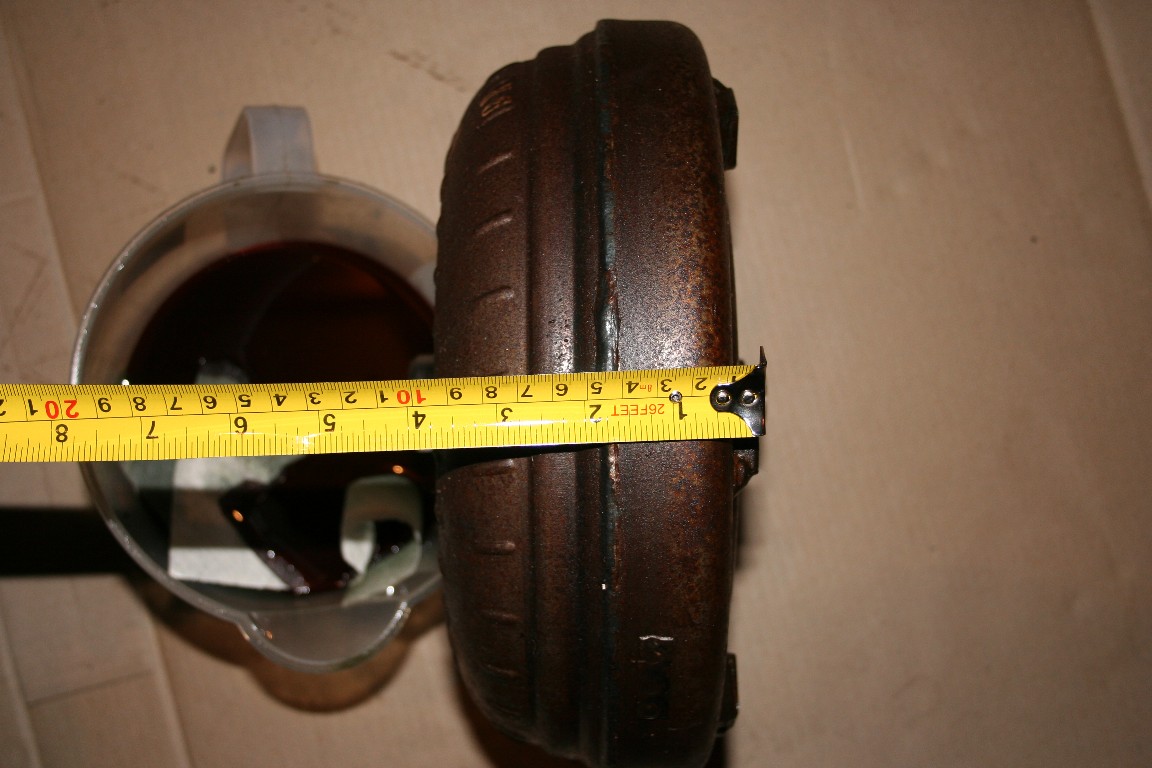

    thing thing i really wanna know now is what are the standard stall rpm of these 2 converters i have. i have to decide which one i should put in the car.

  7. #52
    338
    The smaller one will probably stall higher.
    is it the thickness that matters, or overall diameter? casue they are the same diameter, but the A70 one measures a bit thinner

  9. #54
    338
    Well then the A70 one is smaller
    I think both dimensions matter. Diameter is probably the most important though. But if you have to the same dia then the thinner one will most probably stall a bit higher AFAICT.
    I have a JZX81 Chaser A341LE torque converter sitting on the garage floor if you need measurements
    Here you go, looks pretty similar. A341LE box from JZX81 Chaser.
