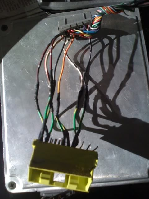

    Default Re: 5ME -> 7MGE conversion in MA61?
    yeah but what wires lol!
    i might have to have a look under dash to understand.
    ive found this pic. is this all that needs to be done on the ecu side of things?
    to me thats the wrong way around?

    all i need is the 5me 24pin plug wiring pinouts
    has anyone got a diagram?
    1,852
    5m should have the pin designation etched into the PCB crack the ecu case open (open both sides)
