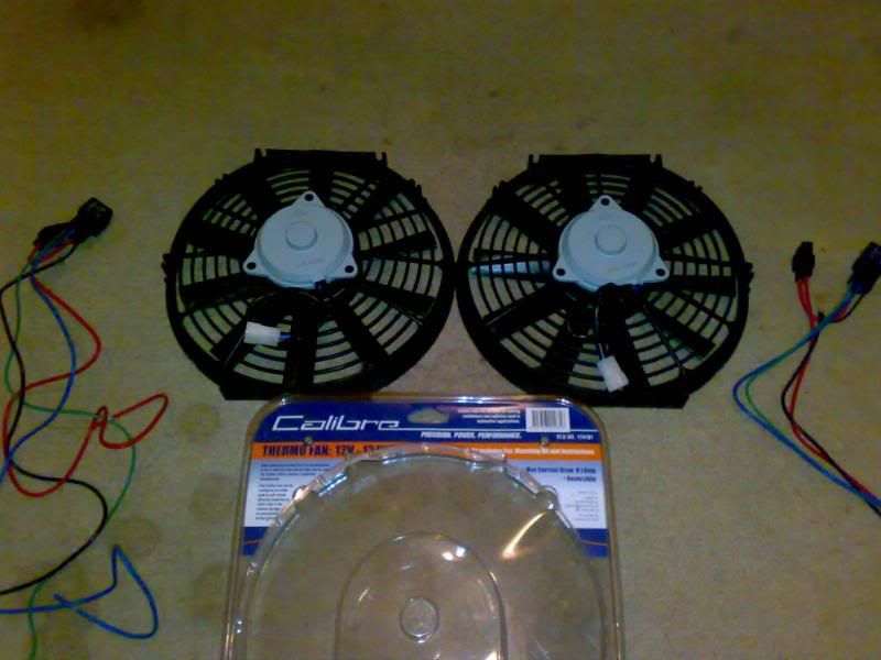

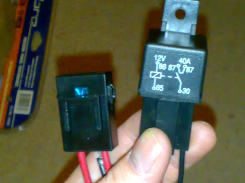

    ok so im wiring my microtech to twin thermos in a 23 celica. just posting here so folks can see how im doing it with the single output from the comp
    i bought 2 supercheap 12" thermos. the brand is calibre and they go for about $60 each.
    the relays that are supplied are 40A so im happy to just run the signal from the microtech in parrallel to each relay for switching (for the n00bs this means the power remains the same for the signal wrather than being split in two when you wire in series, which will halve the 6v power (which is what i think microtech runs at) output to 3v which is hardly sufficient (i think)) the other black box jigga that you can is a 15A fuse, which is also supplied

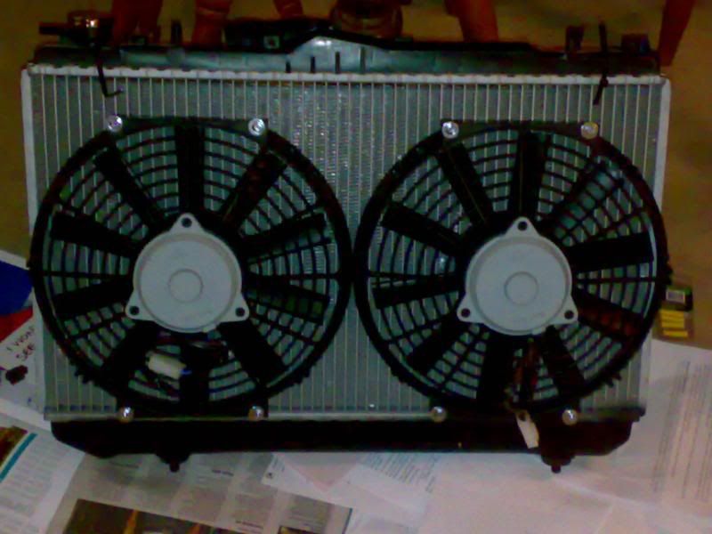

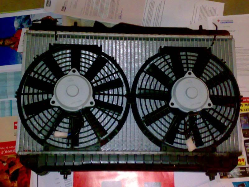

    the fans are to be mounted on a hyundai excel radiator which looks like this

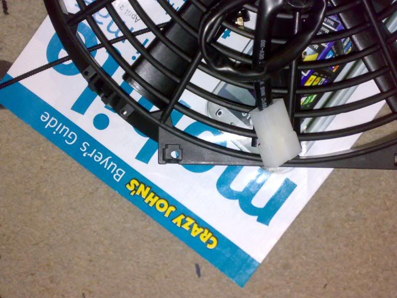

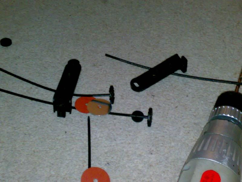

    so mounting the fans is the biggest pain in the arse you're gunna have to deal with. first off you get given a whole bunch of shit, nfi how your supposed to use it. and ofcourse the fins will never line up the way you would like them to
    or you could just line it up and drill through the fan housing itself. much easier.

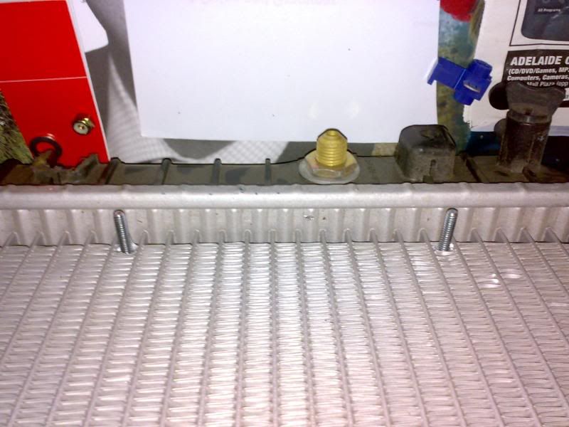

    then put you bolts in and gently tap them. this will show you where to pry apart the radiator fins for you bolts. i drilled mine. i found it doesn't acutally remove any material, it separates in nicely though
    finished
