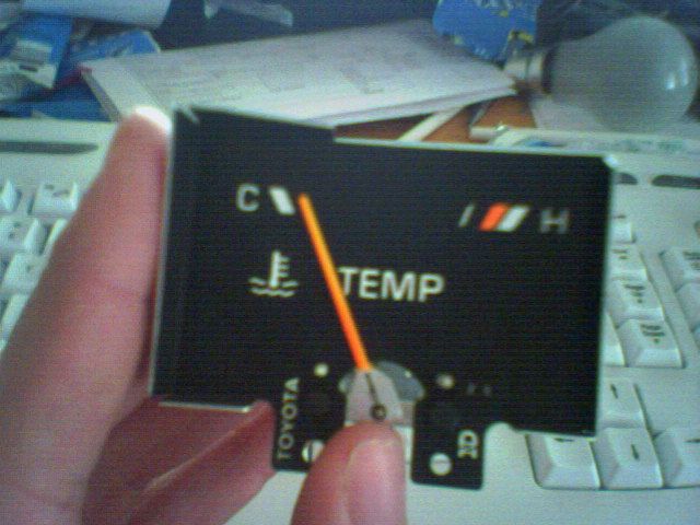

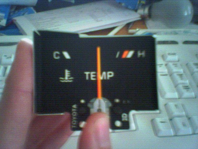

    if its in the middle of the guage like in pic i wouldnt worry too much, thats where my old 4ac rolla used to sit once i had the thermo replaced
    before i had the thermo replaced it would sit just above cold after driving for just under an hour with a lot of downhill which ment accelerator wasnt used/compression braking, after thermo was replaced it would sit between 1/4-1/2 which was alright i think

    Ah you just confirmed it . The gauge is jap ND so it must be the VDO sender in the motor thats not quite exactly matched to the gauge.

    no worries, your lucky i remebered i had the guage sitting in my drawer and that i could be bothered installing the drivers for my IR USB
