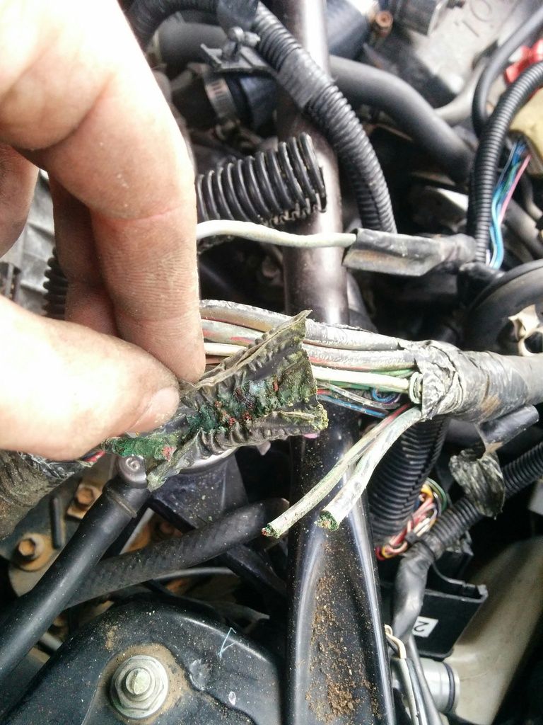

    Finally found the issue! After my last round of troubleshooting I couldn't even get the check engine dash lights to come back on. On the advise of old_mr2 (Thank you!) I started stripping back the loom looking for a short. I figured it would be in the power wire leading into the 15A EFI fuse so I traced that back to a factory splice near where the cable splits out for the engine lid temp sensor. As soon as I went to unwrap the tape around the splice the two wires running up to the fuse box just fell into my hand.
    It looks like moisture had been getting into the loom whenever it spilled out of the filler neck. I checked to confirm it hasn't penetrated any other splice points.

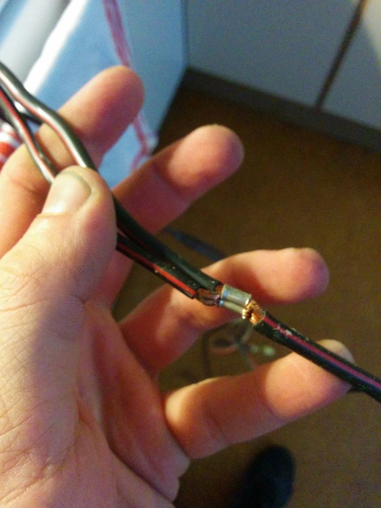

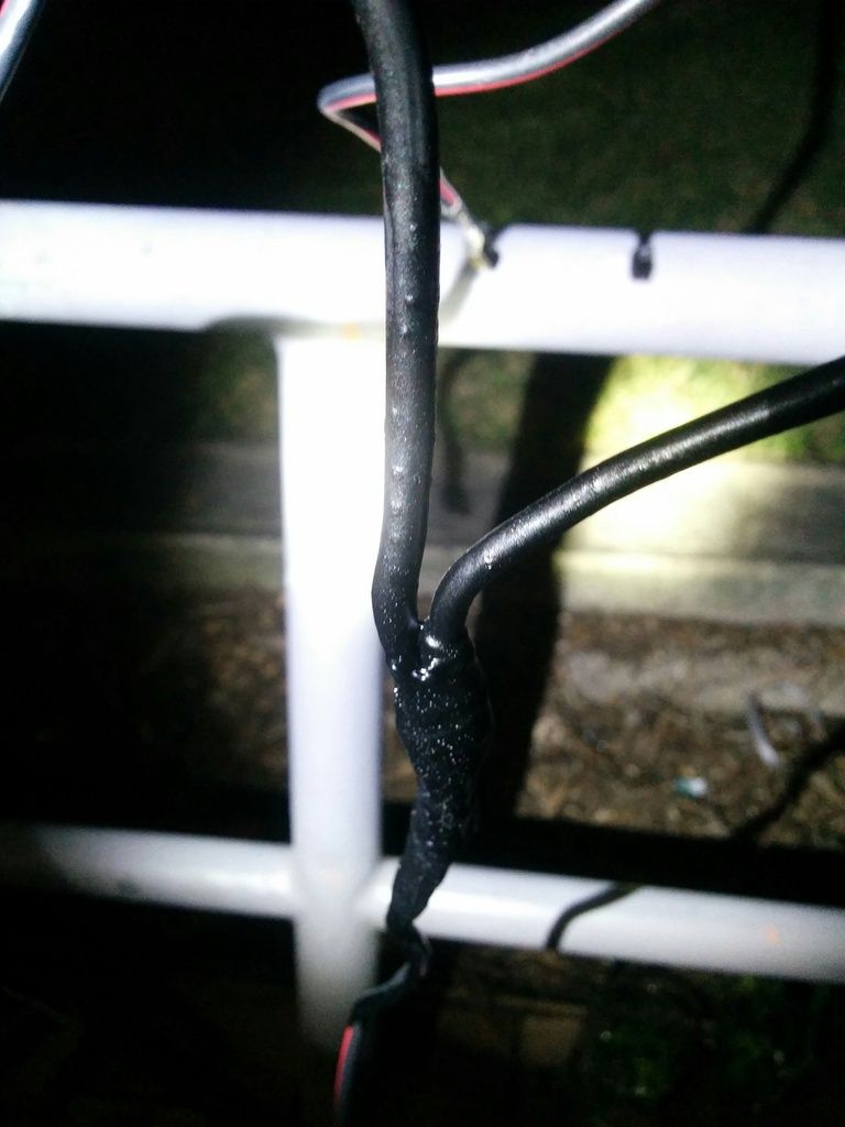

    I had a spare gen 3 loom so I decided it would be better to cut the required cable from that loom and remove the pins from the spare fuse box, seal the factory splice as well as possible with some self amalgamating electrical tape and a squirt of plasti dip then plug them into the existing fuse box and solder the joint further down.
    This is how it should have looked under that tape
    Wrapped nice and tight with self amalgamating tape then coated with plastidip, that should prevent this re-occuring.
