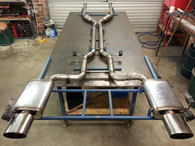

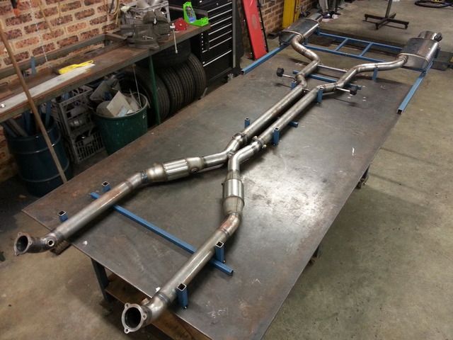

    And a couple of pics of how the rest of the exhaust is progressing now that the headers are back.

    Here are a few more pics of the exhaust
