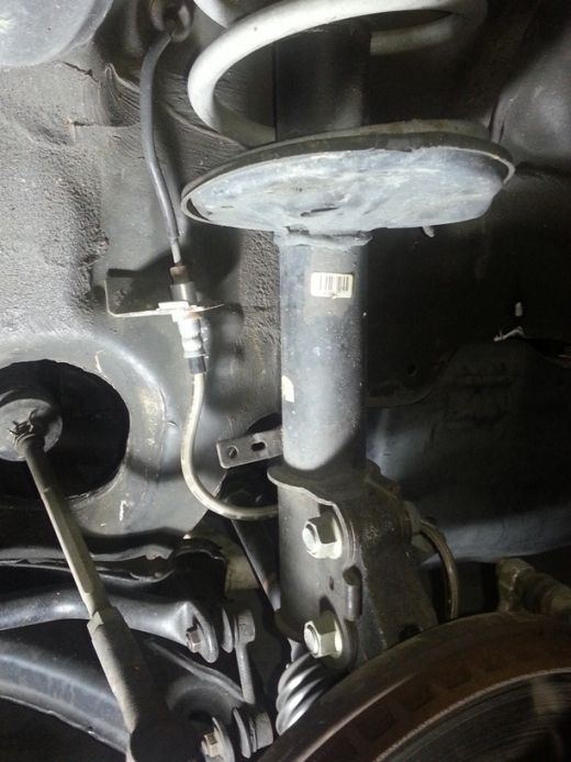

    Post some pictures of what you have and I will tell you if it can be done.
    I think you will find that all of them will require welding as the Koni is a insert and not a strut complete strut leg with a circlip.
    Please note that most aftermarket shock brands list inserts for SX only and complete legs for all other variants.
    The Koni variant from memory is insert only. Therefor there is no circlip.
    You would have to cut of the original spring seat and weld on the height adjustable sleeve.
    Free length of springs depends on travel required which will change what ID spring you go for also. You may need (depending on height required) be forced to run a "tender" or helper coil to keep the spring trapped.

    OK; give me 1/2 hr - I'll go & take some pictures now. . .

    Thanks for that Jondee I now know how to post other / future photos but; referencing the 1st photo you posted I can now see that Racinrolla is correct and that this would be a redundant exercise as I will have to basically grind off the weld / remove the seat + weld on adjuster for this conversion.
    That's OK from a DIY viewpoint but a deal-killer from a financial one as I can't weld so am out at least $250-300 to have said adjuster sleeves welded to the struts PLUS the fact that this kind of fabrication will then need to be certified for a street driven car which means another $500 on top of that going to some RMS sanctioned Engineer for 15 minutes work to inspect said welds before giving me a piece of paper for the RMS & Insurance company. . .
    And I can't even pick my springs; with both GC & HSD its their springs or nothing so I then need to fork out another $500++? for a set of Swifts (which together with track-day adjustability was my main reason for wanting the conversion in the first place).
