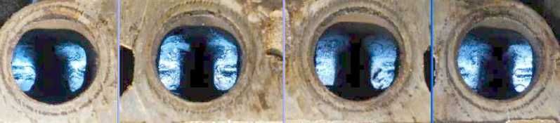

    I can help with one of your questions... The outlets on the early 4AF head are about 25-27mm and in my case very poor indeed
    Just for chit chat sake... There is another problem with the F head exhaust... port #1 crowds the oil drain... and because of it port #1 is partially blocked...

    Thanks for the port diameters, ..if I remember correctly ^^that head^^ you ported is 1st generation 4afe whereas the 7afe and 2nd gen 4afe use a head with an improved port design.
