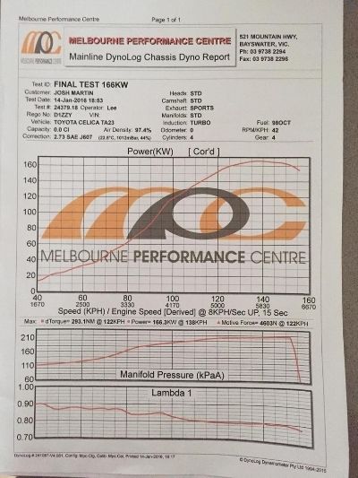

    Wow, its been over a year since this post. I managed to get the engine started. I ditched in the Adaptronic in favour of MoTec. Its making 166 rwkw at 10psi. I'm a bit disappointed with this tbh. Here's the dyno sheet:
    I now have an issue with it randomly deciding to cut out. I can't seem to get to the bottom of this. It seems to run fine for a little while but then cut out. This happens on idle and when accelerating.

    Sounds like something wrong in the ECU, could be a number of things. I'm just about to get my 3TGTE started using a Haltech. In my case the Haltech has full diagnostics to help find issues, does the Motec have the same.
    Might be an earth fault, check you have a good earth...
    IF so, just hook up your laptop to see whats happening. 166RWKW at 10psi sounds amazing, I would be more than happy with that? What were you expecting?
    What injectors, turbo and other mods to you make to achieve that?

    It makes 166rwkw on 10psi and that's a problem?
    That's pretty solid, wouldnt be unhappy with that at all.
    Seems to nose over pretty early though, needs more turbo by the looks of things.

    The MoTec does but it's not picking anything up when MPC had it for the tune. I'm no expert when it comes to tuning. They think it has something to do with the turbo timer that was wired in to it. It's at the auto electrician now having a few things done. Hoping they can sort it out.
    I'm not not happy just not over the moon if that makes sense. I was hoping for a little more and boosting coming on earlier than it is. I'm not sure how much more power I can realistically achieve when winding the boost up though I'm hoping to make 200 rwkw.

    The dyno plot suggests its running around 200kPa manifold pressure, so 100kPa boost.
    160rwkw out of a 3TGTE on 14psi sounds about what I would expect.

    What power could I realistically expect? Is 200+ rwkw manageable with my current set up? This was my goal along with it being quite responsive. I'm starting to doubt that now.

    hmmmmm... power comes on somewhere around 3000-3300, and it tops out at about 5800....
    maybe a bit more cam.... and a bit smaller impeller......

    Your disco potato should get you to 200kw without any dramas. Your injectors are big enough, you have a decent ECU, ask the tuner to turn up the boost! 166kw on 1 bar sounds about right for a 1.8 on petrol without any major mods. Are you still running stock cams diz44zy? It does seem to nose over early but then again I have nfi where a stock head 3TGTE normally peaks, they are a 2V motor so with stock cams etc they probably aren't geared to make peak power all that high in the rev range.
    Either way, my vote is turn it up to 18psi and see what it does
