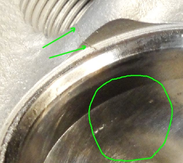

    As many of you know... much of my porting work has been on 4AG heads.... I was asked to port a 5MGE head.
    It was delivered to me cleaned and pressure checked. This is not the first head I've found this type of crack in. I've experienced this twice before... on one head (Volvo "530" head) it was terminal....
    on the second head (Mazda/Fords 2.2) it was checked and found to be tight, and it was ported, I've not heard back that there is any problems with it....
    So back to the 5MGE... the above cracks (top photo) are quite tiny, do not lead beyond the seat, and when it was pressure tested, it checked out ok.... So does anyone have any experience with this on a 5MG head.....???????

    Finding a 7MG head that hasnt been on a motor that's had the gasket fail is quite a task, nearly all 7MG heads are soft because at some stage they got hot
    If you put a good hard head on a decked block, drill the extra coolant galley hole and pull it down properly on a MLS gasket they dont fail.
    How much work is in the head now?
    If its not a lot ($$$) I would be looking for a good core to use, cracks normally get worse lol
    Depends how much the customer intends to use it too I guess.

    concerning the hardness... what I'm talking about specifically is the 5MGE head is MUCH harder to remove material from. The 4AG and 7MG are easier to remove material from.... THAT is all I'm basing my opinion on.... I know the 7MG head gasket fails... my opinion was part of that failure might be related to the specific aluminum alloys they chose to pour the 7M heads from.
    As to how much I've done....... its half finished...

    But with that head - I wouldn't use one with cracks like that; especially if it is for a performance build.

    First:those cracks are nothing;very many heads have them.
