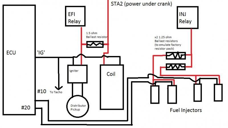

    18RGEU wiring diagram - simple things, aren't they? Note how the igniter is not pictured, that's because unlike later EFI Toyotas, the ECU has no control or feedback from the igniter, the igniter controls all the dwell and timing - exactly like a 21R-C setup (and 22RE????). All the ECU wants to see is the pulsed open/ground signal from the coil, effectively the 'IG' is just a tacho input to give the ECU an RPM reference.
    Image courtesy of RA35GT IIRC.
    Here's how my coil and igniter are wired- excuse the MS paint wiring diagram.

    the ecu won't fire if there's no spark mate.
    it needs to see the flyback voltage, not a ground/open circuit.
    it is a little sensitive with respect to the ignition. (I had rev limit issues using a newer type ignition, but it still started)
    concentrate on getting the ignition to work first.
    (disconnect the ecu until you get ignition working)

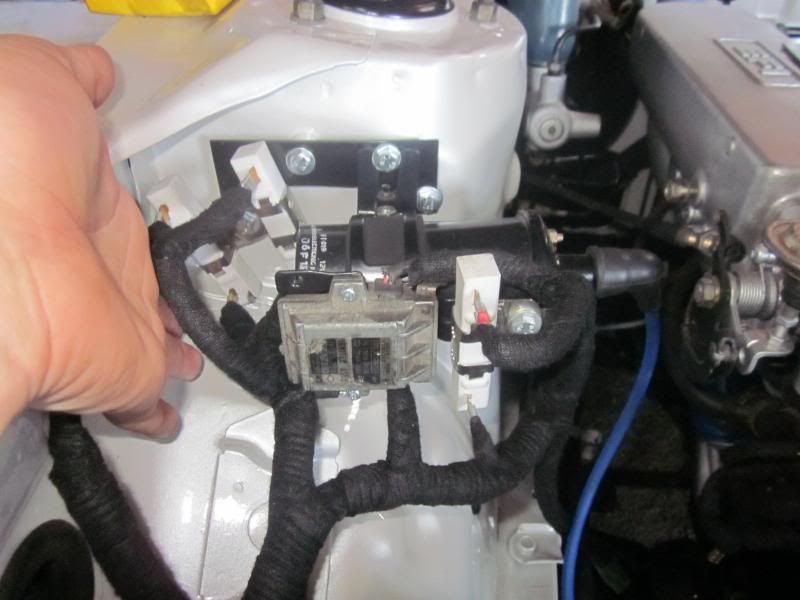

    Coil isn't open circuit. IIRC between 1 and 2 ohms across the primaries. didn't check the secondarys. It's a brand new coil. Bosch coil to 'suit electronic ignition'. Best description I have got. Even if it's not designed to be used with a ballast resistor, it's getting straight 12V under cranking conditions and still isn't generating a spark.
    Coil in question -
    504
    Default Re: 18R-GEU won't fire - no spark or injector pulse - possible igniter issue?
    Well, I tried a conventional type coil on there (as in one to suit points ignition) - no change.
    Looks like the igniter has had it, so i'm picking up another one tomorrow to wire in and we'll see how it goes from there.
