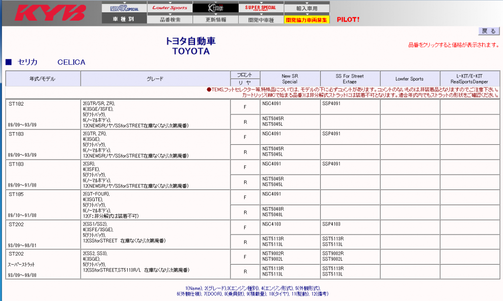

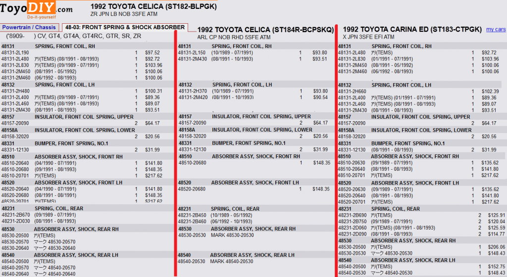

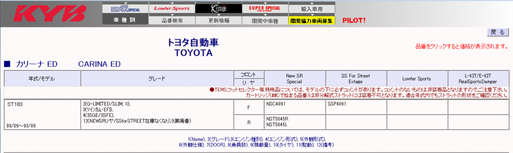

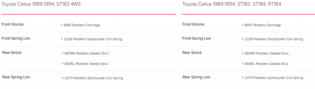

    Sorry for the late reply, I've been a little busy. When I haven't been busy, I've been busy trying to do some research lol
    Just lost all my firefox windows, so I guess now is the time to post what I've found.
    One thing I still haven't deduced.. Will springs for the ST182/4 Celicas fit my car? I made up a comparison picture (last pic), OEM numbers don't seem to match, but then again nothing does perfectly.
    I need to replace an engine mount ASAP, so it would be great if I could figure out if they're the same as other Celicas, or other 3S-FE cars. I'll probably just make another thread up for that once I get my suspension ordered.
    Should also add, I went into Adelaide Tyrepower the other day and the guy said the best bet is to ask my mate who owns an ST184 to come into the shop with me and they can get both cars up and compare.. Which is what I might do just to be safe.
    Shocks are the same as the ST182, ST183 Celicas.
    ST182, ST184, ST183 Celicas are the same. Therefore shocks for the Carina ED are the same as both JDM and ADM/USDM Celicas.
    Tried to make sense of this.. Even though the OEM part numbers are different, I assume they're minor if at all different.. Any easy way to tell if two OEM parts are virtually the same, just slightly different number?
